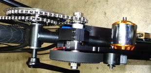

The triangle of the Cortina is just too small but I have so much invested in the bike that, at least for me, it made sense to do one more drive iteration using this frame.
I wanted a drive system that I could mount directly to a round bike tube and I wanted a motor plate that was made for the 80x Turnigy motors. I also wanted to try a belt drive first stage again and get as much reduction as I can in the first stage.
I asked Matt more than a year ago if he was going to make motor plates for the 80x Turnigy motors and he said and I paraphrase "possibly but not high on my list". It was not a no, but it was not a yes either. I asked several times and finally decided that if I want one I would have to make it myself. I also needed a different mount for the drive, the mount Matt provides makes it hard for me to mount motors the way I want. It's taken more than a year but now I want to show what I have come up with.
The 25mm wide sprockets are from Matt. The tube clamp, motor plate and tensioner (really to get more wrap around the motor pulley) I made.
8085 Turnigy with stock wind (will probably rewind this in the future and put in sensors). HV160. 4 or 6 - 25C 6s Turnigy batteries for 48v 10/15Ah.
24" wheels. 13t Crossfire on Matt's adapter. Stand alone high amp CA.
