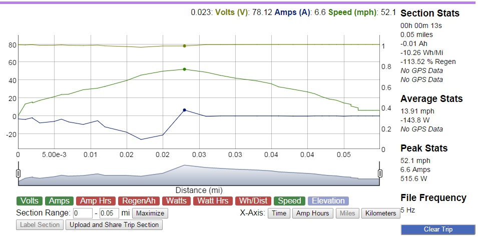

I'm working on a EV goKart with a motenergy ME1115 motor. The top speed while the wheels are off the ground is 51.8 the top speed in about a 1/4 mile straight away on the ground is 31.5
Is this normal? Even if the straight away was 2 miles I don't think the kart would reach upper 40mph so is it just an acceleration issue or power issue?
I am using a sevcon gen4 motor controller and I have the can-usb connection. Currently the motor controller is configured by thunderstuck for the motenery ME1115

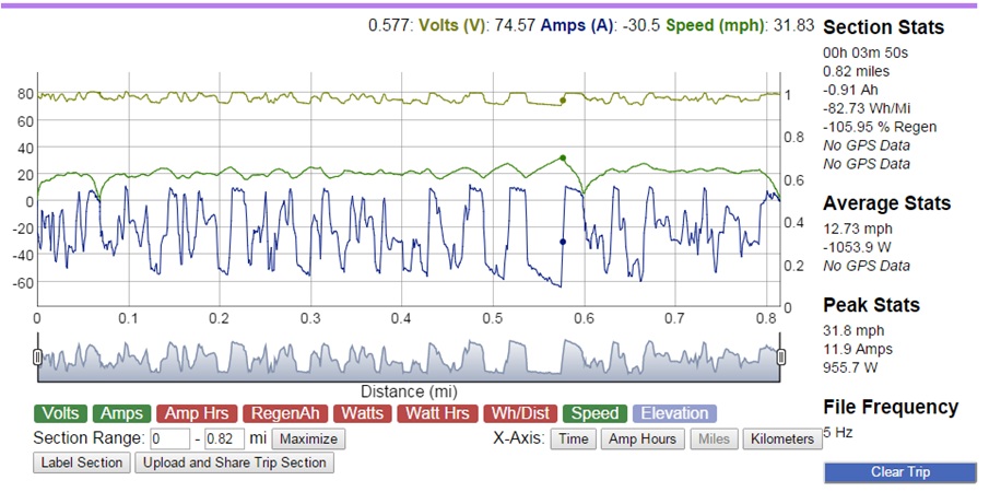

These are the trip analyzer graphs for both trips.
This is with the kart wheels off the ground.
This is a test run around a parking lot
why is the mph almost half while on the ground. I understand weight and acceleration are factors. But is this something I can mess around with using the DVT software and CAN-USB connector?
