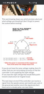

If anyone out there can, it would be much appreciated if you could post the voltages of the red, white and black wires on a working unit. On my unit when you unplug the cable from the sensor and look at the cable's female plug end with the flat portion down, the white is on the right, the black is on the left and the red is centered on top.
Also, it would be helpful if someone could explain in terms that are not too technical how the three wire sensor works with the C965 display. Is it something as simple as one wire carries voltage for the light, one functions as the ground and the third carries on and off continuity through a reed switch? Or is this the hall type which I don't really understand?
Typically the red wire is 5v power, black is ground, and white is the signal. On the BBS01, I don't know if this is the case.
Ground and 5v are pretty simple. 5v stays on steady when the power is switched on.
The signal line is normally high (5v) until the magnet is close, then it toggles low and returns to high once the magnet moves away.
If the signal line is shorted to the 5v line when it tries to pull down, it can fry the hall sensor. Randomly applying power to the wires is usually another good way to fry the sensor.
You can use the main battery negative wire as a reference and measure the voltage on 3 wires going to the sensor. You should have 5v on at least one of them.
Using Fechter's suggestions I did the following: Turned on the battery pack switch, powered up the speedo display and checked the sensor cable voltages this time using the battery's black wire ground. Red is 5 volts, white is 5 volts and black is low millivolts or zero.
I also once again checked the wires with each other: Red to black, red to white, white to black...all produce only millivolts.
Maybe this is confusing to me because I do not fully understand electrical circuits. At the sensor cable end, doesn't there need to be a positive (5 volts in this case) wire (usually red) and a ground wire to complete the circuit? Or is there something about Hall sensor technology I don't understand where the current path is different?
You're right, the hall sensor needs to complete the circuit.
From the measurements, it seems like your ground (black) wire is broken somewhere.
Try putting your meter in ohms mode, power off controller and measure resistance from battery negative to the 3 wires. The black wire should show near zero ohms. The others should show something in the kOhms range.
Fechter- Connecting my digital meter on the ohms setting to the battery pack negative and the black produces no reading...an open circuit. The red is 26 Meg and the white is 6.9 K.
Assuming the black ground is somehow disconnected/open in the sealed controller, can the black wire be connected safely to the battery negative to fix this problem?
One more thing: I posted originally that when I tested the sensor red light that it would only light when I connected positive voltage to the white wire and negative to the red. That was mistaken. It is the reverse. Positive to red and negative to white makes it light. No combination of using the black wire with my 12 volt testing source to white or red makes it light up.

Right. Red and black supply power, which is constant and powers an amplifier circuit inside the hall sensor. The 3rd wire is for the signal which goes low when the magnet is close.
Yes, it should be OK to run a wire from the battery negative to the sensor.
I connected the black wire to the battery pack negative, turned the display on. No red light. I passed the magnet by hand past the sensor. No change at the display and no red light.
Deciding I needed to confirm that the red light actually still works, I disconnected the wire (above) to the battery pack and connected 12 volts DC to the black and the red...no red light. Connected 12 volts to the black and the white...no red light. Connected 12 volts to the red and the white...no light. Switched polarity (+ to red and - to white) and the red light lit up just as it had in the past.
Is it possible that the functions of the wires are different than we think?
Totally possible. Since the wires are nicely bundled up in a cable and I can't see which color goes where on mine. But I am pretty sure one wire has to be ground, one is 5v and one is a signal.
It's also possible the sensor is toast, but the LED still works.
One more test: try taking the white wire and briefly touch it to the battery negative line and do this repeatedly to simulate the sensor working and see if you get a reading on the speedometer.

Note. Correct mounting of the sensor & tests.
The sensor MUST be mounted such that as the wheel spins the magnet passes the sensor across the diameter of the sensor.
If the sensor is mounted such that the magnet passes the sensor along its length, the sensor will not trigger and lead to an error 21.
To test the sensor simply swipe magnet repeatedly across the sensor. Red LED should go on & off and produce aa speedo reading.
To test wiring, repeatedly short & disconnect the black & white wires to produce signal to controller, again speedo reading should result. (Do not short Red)
To test cable: meter cable, Red(supply) to Black(common) 4.8v.
Black to White(sig) 4.9v
