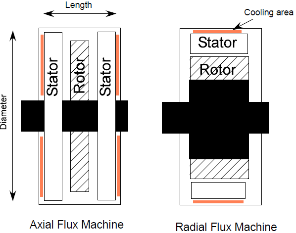

Unlike radial flux motors with a cylindrical rotor turning within a cylindrical stator, axial flux motors use a disc-like rotor sandwiched between two (or facing one) disc-like stator(s).

Axial flux motors. Unlike radial flux motors with a cylindrical rotor turning within a cylindrical stator, axial flux motors use a disc-like rotor sandwiched between two (or facing one) disc-like stator(s).
Advantages to this type of motor design include higher torque density; better cooling due to higher contact area; high efficiency due to lower cooling losses; and better overload capacity.
Although the axial flux concept is not new, commercialization has been hampered by materials limitations and design tradeoffs. A number of companies and research organizations are working with axial flux technology currently (e.g., earlier post).
