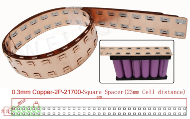

Yeah, I'm currently eyeballing some of these 70A 21700's like the EVE 40PL that can, apparently, handle 70A discharge. A 3p could do the trick (210A), but I'd certainly like to hit 4p for better overhead margin. Getting 26s4p (104 cells) onto the bike somewhere (along with the bms for that) could end up being a challenge. Heck, even a 3p build (at 78cells) is more than the largest pre-made case can accommodate.

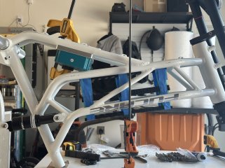

I'm hoping the "cradle" shape of the frame lets me build a bit larger than the standard ebike battery shape, and then up a bit to get it to fit. Probably just hold the battery in with some ratchet straps or something, lol. It's a bit of a gamble, if I'm being honest.
Ah, just realized it's indeed open at the top. That should allow you to go a good couple cm above the top tube, and then 26s4p should fit fine, especially if you put the controller "outside", e.g. at the bottom.
Yup; one of the big reasons I picked this frame as a base. And I'm pretty sure I can jam the controller in that little triangle at the bottom. But I won't know till the frame gets off the boat and over to me. :)
