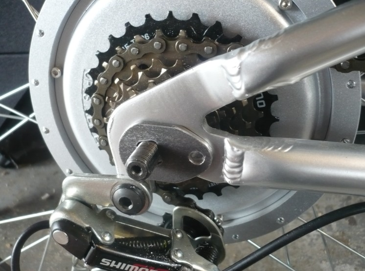

I have a Xlyte 406 rear wheel or a Suzhou Bafang rear wheel to go in it, each with a 6 speed freewheel. They are set up with standard connectors for easy change, but so far I've only tried it with the Xlyte, which is the more powerful motor.
The bike frame is aluminium so I made some simple torque washers.
They hold nicely with the Xlyte.
Nick

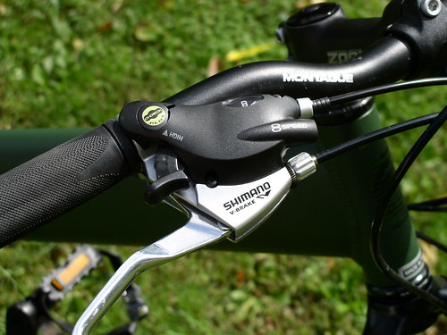

The Bazooka will be arriving tomorrow and the next thing I need experienced input on is throttle type. I have a full twist from Brett, but the grip is hard plastic and I don't really like the idea of full twist on a bicycle.
Who knows what the best type of throttle is for use with trigger style shifters?
Feel free to point me to some threads or to starting a build thread.
Here are some pictures of the type of shifters:
Pictures from the actual bike:
