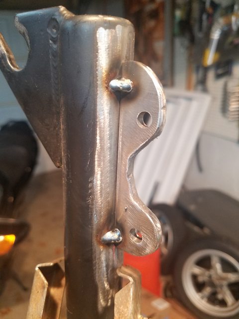

A bit of crude fabrication,

Beefed dropouts,

Built a parallel harness and used some hardware store brackets to get up & running with two batteries. Now it's only pulling 15.2A per pack, so that should make them happier/last longer.
Got regen working, but it's much too strong. Locks the rear tire up for a split second every time i pull the lever.
And the Sunwin controller has a 3 speed switch. With no load, the wheel spins allot faster on "high", but when riding its 32mph top speed no matter what speed mode is selected. Not sure what's up with that...
New top speed!
High speed mode kicked in randomly today on a ride. Not sure why it doesn't work all the time, but I'm stoked. A 40mph bmx was my goal with this project.
