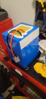

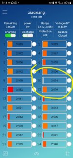

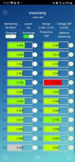

Hello all,
I recently bought a brand new 72v 50ah LifePo4 battery off aliexpress from X N technology that uses CATL cells. The thing seems to have the capacity more like a 25ah than a 50ah. My pooched 41.6ah li-ion battery has better range than this thing.
It never charges past 81-82v. always has one cell that is high (3.6v around there) which prevents charging the battery to it's full capacity (lifepo4 charges to 87, not just 84 like li-ion, right?).
My first test run on a 40km commute one way had me stranded at the last 7km due to the bms tripping and shutting everything off, and i mean everything...because a cell or two got too low in voltage (low voltage protect). But before it got close to that, it was running pretty good. Sag was decent, from 81 down to 76-78 on full throttle which for me is 70 line amps, 200 phase, 5kw nominal output, field weakening strong.
my 2nd test run I was more conservative with the throttle (another 40km). At the last KM or two, the battery died. it always does this thing where at around 70v, it will go down to 69, then 64, then eventually nothing and completely offline (my voltmeter on the handlebar). I knew it was going to die so i just pedaled the bike home then did a little test run around the house to see when the battery will actually die die.
Here are two videos, my settings on my xiaoxiang BMS and a screen recording of bms monitoring cells and so forth right before the battery dies.
What gives? Did i purchase a lemon, or is there a setting or two that I have wrong that is causing this?

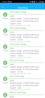

Couple of things could be the culprit.
First, it does seem like while the pack as a whole might not be bad, you are correct in pointing out that cell 22 reaches top voltage before the rest of them. And when I skipped to the end of your video where you are showing the low volt cutoff, cell 22 is at about 2.6v, while the rest of them are around 2.8v. Based on that alone, it appears that you have a single weak cell that's bringing down the rest of the pack's capacity; ie, a pack is only as good as its weakest cell, and #22 appears to be the weak cell (#10 appears to be the second weakest cell). So, one possible answer to your question, is that you possible do have a pack with 1-3 bad cells, perhaps a lemon. You could potentially show the seller this data and see if they might offer you a refund, discount, replacement, ect.
Second thing is nobody's fault, it's just the way LiFePO4 behaves, relative to Li-Ion.
That's just what LFP cells do when they get to around 3.0v.
If you look at the chart, you'll see that the voltage will drop off hard once it gets down to 3.0v. Especially if you continue to pull current from it, which you were doing in the video.
If it's any consolation, you're not doing anything wrong, regarding either BMS settings or use. LFP is just less energy dense that Li-ion, and its voltage drops off fast at the bottom of its capacity. You could definitely argue that you have 2 bad cells that are bringing down the capacity for the whole pack, and you could choose to top- or bottom-balance the pack depending on your preferred use case, to get a bit more range out of it.

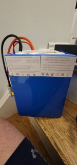

Thank you for your information.

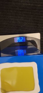

Old battery and new battery on a scale pics below.
I did not pedal home from far. 1km. Pedaling to work where it died was 7km grueling because the bike is a 26x4 fat tire bomber clone hat weighs about 250lbs I weigh 250lbs but the old battery did handle this no problem. Plus more.
I am going to take both my batteries to a battery guy to have both inspected for repair. I'll update as this goes along.

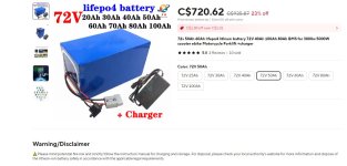

Here is the direct link to my purchase:
https://a.aliexpress.com/_mq9yGbm

Sorry to say, it seems like you likely got the short end of the stick on your new buy. When I click on the link, the page is gone, likely meaning the seller sold a few packs and wrapped up the shop.
The weights don't match up well, either. 36 pounds (16.5kg) for 3.6kwh (72v x 50ah)? That's 218 wh/kg, which is basically the very best quality LiFePO4 cell you could possibly get on the market right now. Not even counting the weight of spacers, wrapping, cables, ect. Safe to say, you don't have those level of cells in your pack.

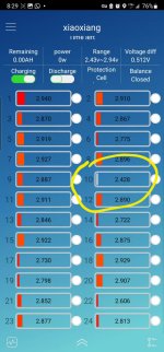

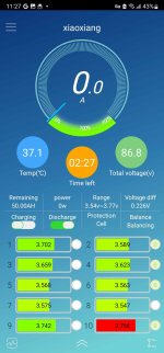

PROGRESS UPDATE

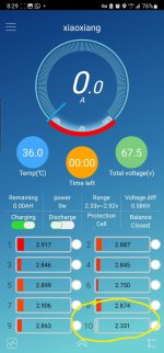

After doing a full charge, I hit "reset capacity" on the xiaoxiang BMS app, then went on a 7km test run (hard riding), got home, plugged in the charger and NOW it reached 87v on full charge! The cells are imbalanced as hell, but once at full charge, they start to self-balance as per BMS function then float at around 84 for full charge.
I also realized that it was series 10 that tripped my cutout this morning. It hit 2.5v but none of the other cells were even close to hitting 2.5v. This is making me feel that this is more of a cell balancing issue than anything at this point.
Now with the battery charging properly, I shall do another test run and will monitor all the cells to see which one (if any this time) goes way out of balance to the point of prematurely tripping the BMS and not fully utilizing it's range.
Oh and I was told that this battery is 3600Wh so with that being said (if true) this assumed CATL battery SHOULD at the very least get me to work (40km one way) without tripping, I would think.

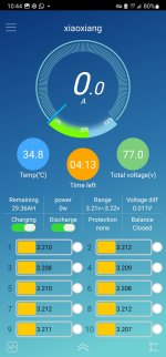

UPDATE
After a few full charges, the cells seem more balanced after a full charge. I re-configured some settings on the BMS and on my controller. I set single cell cut of at 2.5v and set my controller to cut off if voltage hit 67v assuming that will happen before a single cell hits 2.5v. I also changed field weakening to the weakest/slowest setting.
2nd attempt commuting to work, I actually made it with 65% battery remaining! not a single cell got close to going under 3.0v. I was conservative with my throttle and didn't hammer 5kw for any extended period of time, maybe for hills and that was it.
I charged up to full and after my shift I went home, same distance (40km) but my commute home is all uphill. Again being conservative with my throttle and monitoring every single cell, Once again I barely, and I mean barely got home. Cell 10 seems to dip way more than the others and the group voltage is around 70v when a single cell dips to 2.5v for cutoff
This may fix itself with a few more charges and discharges as it might just be a balancing issue but if it does not I'm going to request warranty or cell 10.
Will update in a few. In the mean time, this is what the seller had to say about my lifepo4 battery and how the cells bounce around a lot.
I also attached screenshots of my cell status when I got to work. So going to work looks promising. Going home, well...I guess it's all the uphill riding.

UPDATE
After another cycle or so, cells are more balanced and charges fully properly now. Discharge is better. I did a hard 30km ride, 5kw the entire time and saw my group voltage go under 70v without a single cell tripping. I monitored the cells closely. There doesn't seem to be a specific weak cell, just a random cell showing drainage quicker than others near the bottom end. This might get better with another cycle or so as I read somewhere that LiFePo4 cells need about 4 cycles to balance properly.
It is looking promising...if I can just get home without it dying or getting close to, I'll be happy. Tonight will be the test, will update.
Oh and my 10a chargers only output about 7amps. Seller partial refunded for the lack of 10amp charging. The gauge of the wiring on these chargers is pretty thin compared to my li-ion 10a charger and that kinda gave it away...but got partial refund so, good from the seller ^.^

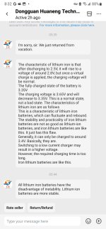

BS on two points in seller communication:
a) 3.35-3.40V is about 60% state of for LFP (see for example Understanding the LiFePO4 Voltage Chart. ), far from fully charged as seller claims
b) LFP is supposed to be more stable than Lithium-ion, exactly the opposite of what the vendor says.

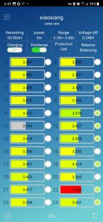

UPDATE
I did a hard 30km ride 5kw the entire time, nothing tripped. One cell was getting a bit low, but not low enough to trip anything. I changed single cell low voltage cutoff to 2.65v, might change it to 2.75v just experimenting to make sure I can get home okay.
Later that day I did my 40km ride to work and it was fine, had over 50% battery remaining. Going back home, I kept it at 3kw or under 98% of the time and I got home okay, but as usual, a single cell dips lower than the rest by around 0.5v. It climbs back up if I ease off the throttle and it's never the same cell that does this, but it is always a cell in the bottom end.
I'm at the 4th cycle now. I left the charger plugged in and will leave it there for 10 hours to allow the cells to balance. I will update again to see how this does on my way home from work tomorrow morning as the 4th cycle is when the cells are supposed to be fully balanced, according to what I read.

Repeatedly balancing a battery pack with a poorly performing or defective cell does not actually repair anything. It just temporarily reduces the undesired effects of the problem until the next cycle.
Wellva
Well as mentioned before its not a specific cell that keeps dropping quicker than the others which makes me think it's a balancing issue. Time will tell.
Update
Well, you were all right. Garbage cells and fake capacity. I took the battery to a specialist and he did a capacity test. This turd has the capacity of 24ah, not 50ah. Explains why at 70v group voltage the battery is dead.
I learned my lesson. Can't cheap out on a battery. I already forked out the proper dough to get the proper battery this time from a local legend, using Murata(Sony) VTC5a cells.
