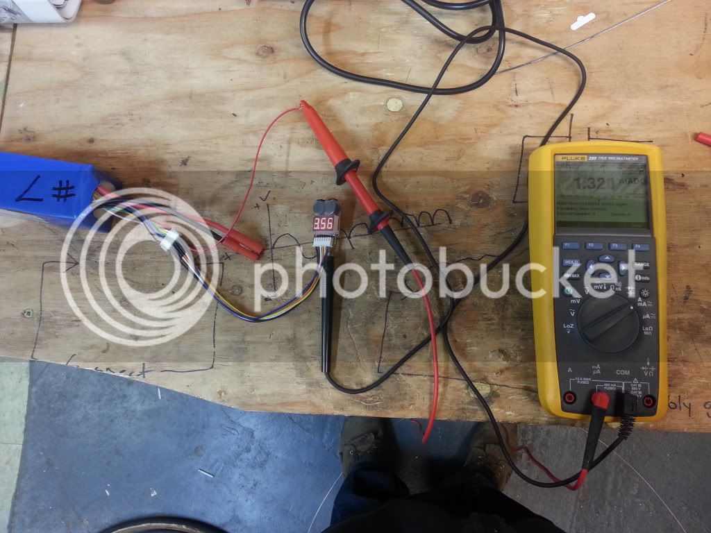

And the test equipment:
be back with results in a bit.

Fluke 289, factory calibrated 11/14/2011
V1-3.1942
V2-3.5290
V3-3.4819
V4-3.5552
V5-3.4779
V6-3.5186
Vtotal- 20.750

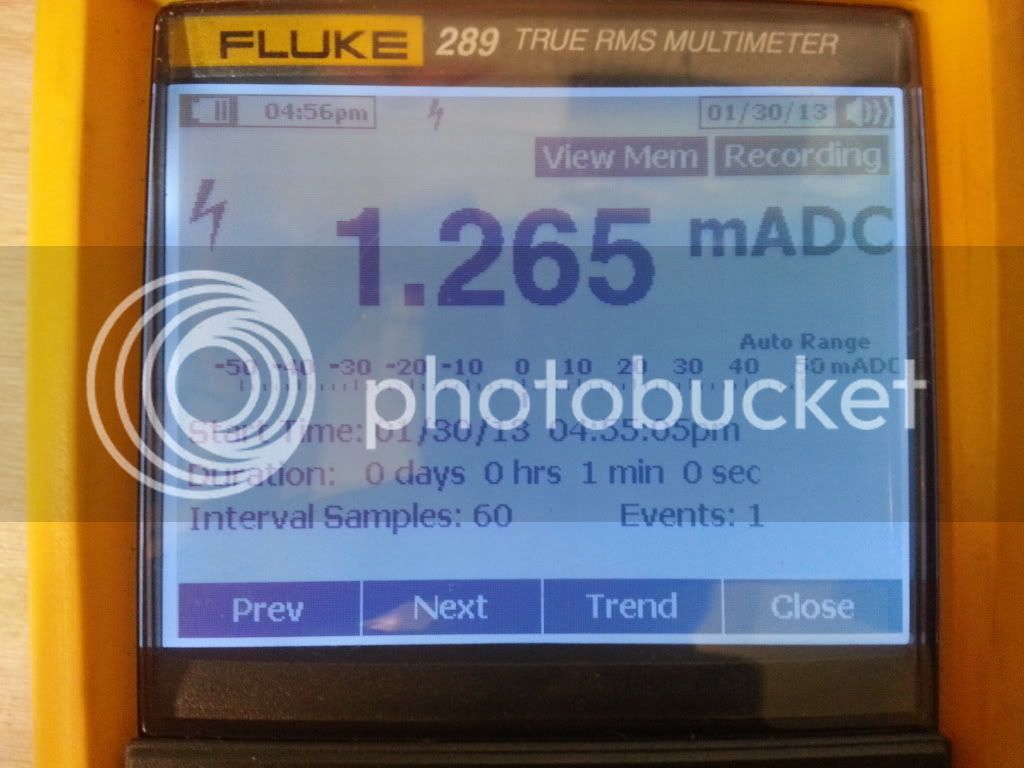

I took some graphs of ma / time and they are interesting, It seems to fluctuate quite a bit as the buzzer translates through different phases of measurement. But it turns out that I need to buy a special IR data cable for this meter, so detailed graphs are going to have to wait. Here are some screenshots instead:
*EDIT* pictures were huge, so heres two. you can manually cut and paste to see the rest:

Looks like the peak current when the buzzer is going off is around .091A on a 50% duty cycle.
the data from the massive pile o o pictures up there is this:
Average current draw per cell in ma:
A1: 1.265
A2: 1.023
A3: .744
A4: .616
A5: 21.530
A6: .041
A total: -23.981

So, some good news, if you disconect the most negative wire. The drains are these:
A1: 1.165
A2: 1.075
A3: .643
A4: .501
A5: .041
A6: .041
A total: 3.469
You need one of my even drain boards :) Perfectly even drain across all cells for cell-logs, and these things now too.
