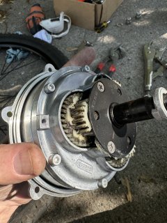

I have a G320.250.R front hub motor with a KT36 / 15A controller on a Yuba Mundo V4.3. Total weight about 400lbs with me, bike, & pax. While riding today with the two daughters, suddenly the motor started going thump-thump-thump as the wheel revolved.
I noticed the front wheel doesn’t rotate easily backward (but don’t remember if that was always the case). It still freely rotates forward. Without power, there is no grinding or thumping, and it doesn’t have obviously more resistance to turning - it free spins and slows down at about the rate I would expect.
With the front wheel lifted up, it rotates under power easily but still thumps. While driving, it feels like it generates less power.
I have a EggRider and its current display seems to spike rapidly but intermittently to about 13A.. I believe previously it fluctuated but was always about 7A.
I can’t audibly tell whether the thumping is coming from the motor or the controller because the controller is mounted on the front fork arm.
This has been working fine for about 300 miles / a year of service on short trips. This was another short trip when it started doing it.
How can I tell if it’s the controller not actuating a phase correctly or if it’s something inside the motor and a mechanical problem. It was one of the ebay’d $50 motors, so I’m not that upset, but I’d like to know the problem before either replacing the motor or upgrading the motor.

Geared motors are sensitive to forces/weight and the gears ( usually plastic ) tend to break in them as a result. 400lbs sounds like trouble for a geared motor, but not a DD.
If you have a throttle, you can put the front wheel in the air and see if you can hear the thump. Maybe flip the bike upside down and listen to which component is making the noise.
My money's on - you're missing a few teeth in your geared motor from the high wear.

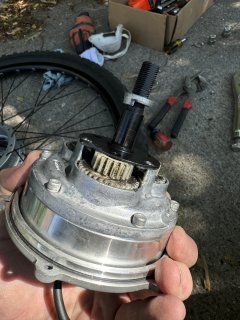

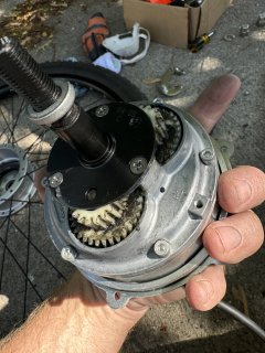

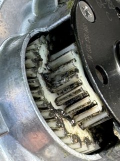

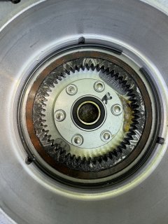

I opened the case to look at the gears… i couldn’t easily turn the planetary set, but I did see at least one chip on a nylon gear. That, plus the fact the tire no longer freely turns backward makes me think you’re right, though I don’t quite understand the mechanism of that…

Btw, when I put it back together, it seems the planetary wasn’t engaging the main gear… perhaps a shim I missed? Anyone know if there’s a specific process for reassembly?

I don't see this knick.
Once gears start to go, things get worse quickly.
TBH, this motor is a dual reduction type and these are even less durable than the typical geared motor and you've got heavy weight.
You could replace this but you will need to do this often.
Unsure about the replacement procedure, even if you put things together correctly you could have unsettled the gears in the process.
