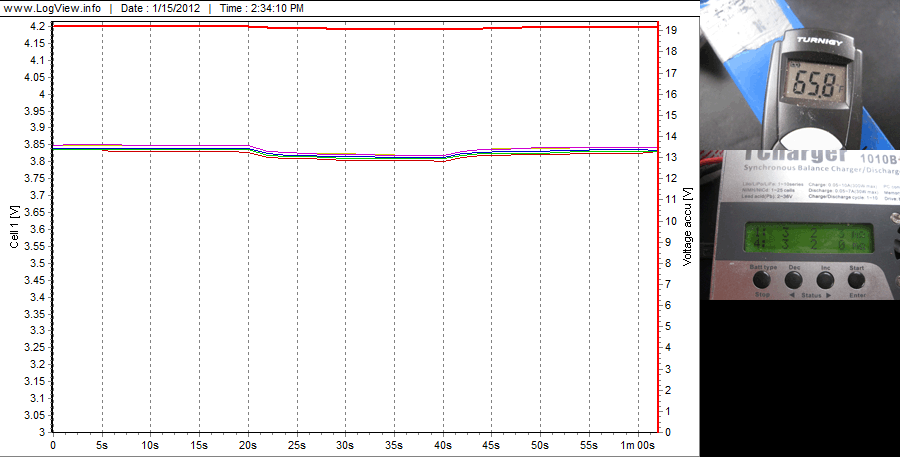

So.. i had noticed lowered top speeds and worse acceleration out here during the winter with my RC lipo.. many people say that RC lipo performs poorly in the cold.. i had to find out exactly how bad it was..
Took 1 of my funky Turnigy 20C 5AH 5S packs with a weak cell #5 ( bad from the factory ) with about 1 year of life on it and a total of 10 light cycles on 'er..
The pack was charged to the nominal storage voltage ( 3.85v ) before the tests.
The load was 3.85A, just around a 0.75C load.. using two 50W halogen in series for a total of 100w ( which is voltage dependent, so the real power draw was more like 70-73w )
First test.. room temp at 65deg / 18.3C.
Average internal resistance, about 2.5 mOhm, not so bad. This pack was about 2mOhm when i first got it..

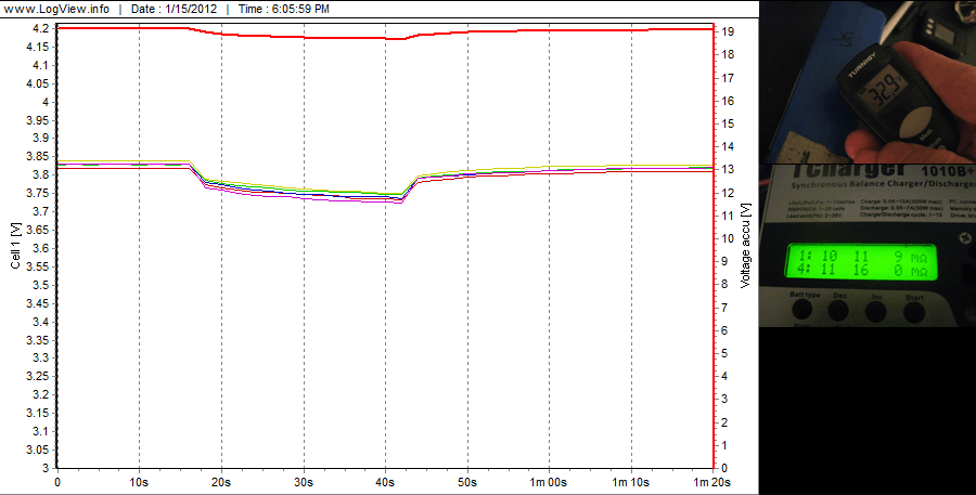

Got impatient and gave it 30 mins. in a 5F freezer :twisted: came out @ 33F / 0.5C..
Average IR is 10mOhm, if you don't consider that cell #5 is starting to act up here.

Since IR ( in mOhms ) is a measure of internal resistance, and an indicator of how much voltage sag & heating will occur from a given load, we can sorta think of the battery as losing it's C rate according to temperature..
If 2.5mOhm is a 20C cell..
7 mOhm is more like a 7C cell..
10mOhm is more like a 5C cell..
15mOhm is more like a 3C cell..
:shock:
Good thing i run a lot of amp hours. If the sag jumped that high on 0.75C, just imagine it at 2C-10C.. :shock:

I supose that V jump down is on load connection and jump up is on load disconnection. Have you tried to let them connected for a wile? Bigger sag is quicker heating, I wonder how long would they need to heat up and recover (in freezer conditions on different C rates).
Yes, exactly. I connected and disconnected the load to observe how long it would take to spring back to the normal voltage.
The higher the internal resistance, the longer this takes.
