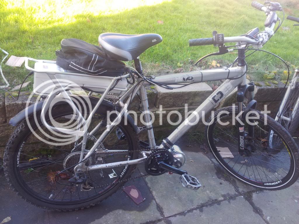

Not a bad bike to start with. The 26" version of the same thing, trek 820 is an often recommended bike for the first ebike conversion.
On a cruiser, Id say go the front hub, but on the bike you have, I'd recommend the slower versions of rear motors from EM3 ev. The skinny tire makes riding a front hub trickier than a fat cruiser tire. They will have the power to climb 10% no problems from overheating, with moderate pedaling help from you.
Sla's could work, but a 48v 15 ah or 36v 15 ah lifepo4 would be best. Either could be carried in the big frame triangle of your 700.
