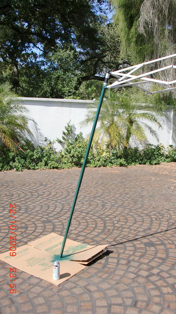

="Fusion" is an all-purpose paint, but where it really shines if if you want to paint a poly lawn chair or mailbox, etc:
no other "paint" will stick.
=Fusion can be used on any surface. It is on poly-plastics, though, the can directs
that you should scrub with ammonia water or lye water... *rubber gloves*,
to give the "paint" a sort of chemical affinity for the surface.
= The acetone-rag test, however, shows that this canopy frame is factory painted in baked acrylic enamel: good, old time paint.
Powdercoat is superior, but you won't see powdercoat on cheap stuff like this frame. PC is harder to paint over; you have to thoroughly "key"
the surface with your wetted 3M green pad, for powdercoat, in particular because Fusion is "nonpolar" to powercoat plastic,
which paint is not really a paint...
OK! Fusion is like Krylon: fast, fast to "dry": no overspray worries of sticky-forever Rustoleum-type alkyd spray enamels.
Prep: five minutes to lye-scrub the four legs, just the portion that shows....Rinse. Acetone test: bites. Good. Adhesion is assured!
=am not painting above the canopy-line. No need.
Fifteen minutes more in the sun, and...time to paint: about fifteen minutes work all told.
Fusion dries in just a few minutes, to the touch, and the canopy top can go back on in an hour in the Florida sun.

The four legs are now painted and about dry enough for me to get the canopy back atop (five minutes work, it Velcro's in place)
