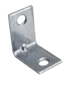

Thanks. Would you have recommendation on how to persist? I could grab the less corroded one with pliers in the back but the more corroded one would just slip and slip and now the edge is not a flat surface anymore: it’s rounded from the pliers ripping so there is no leverage to be had there anymore. And I can’t use the grooves because I only have an 8 screwdriver when this seems to require a 10 or 12 (but would the tip be too thick wouldn’t it?)
The last really stuck one I had I looked around for anything metal that was the correct width and thickness . It ended up being a right angle bracket . I held that with some vice grips and pushed into the slot with one hand and used the Allen key with the other . A good soak with some penetrating oil can help as well . If all else fails a drill is the last resort .
