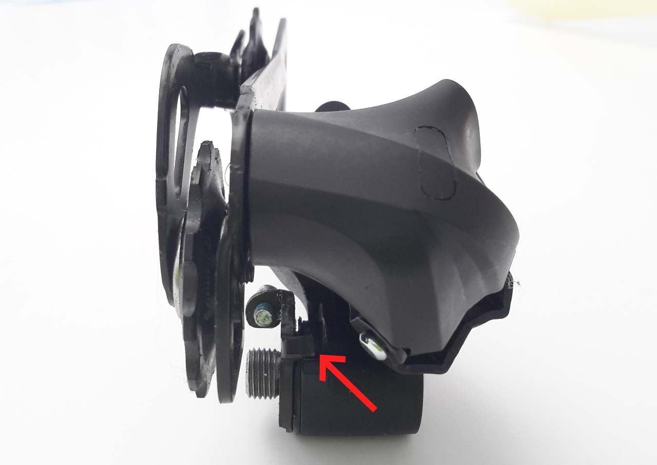

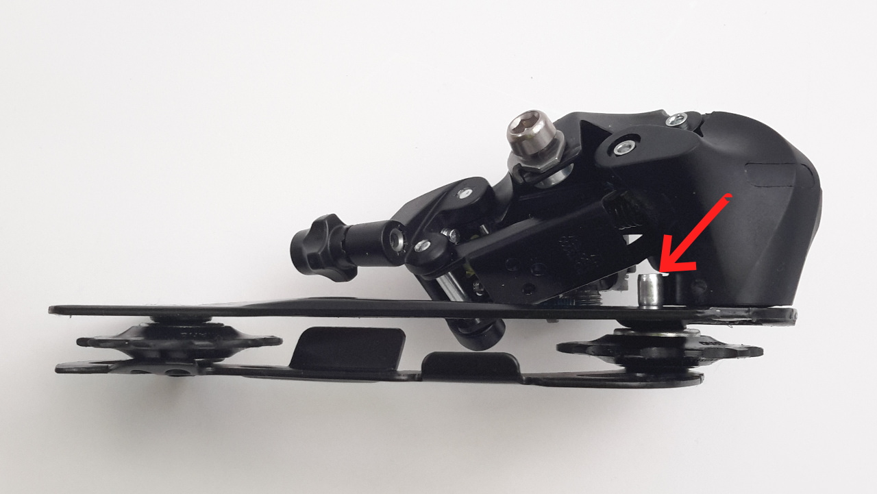

I've been working on a 2-direction derailleur concept to collect braking power, and came up with the following idea:
Rear derailleur come with a system to block it rotating backwards. This blocking mechanism is divided in two parts:
1. Hanger bolt blocking
A small metal arm located on the hanger plate is bent towards the upper arm and hits a "blocker" cut into the metal housing of the upper arm.
2. Lower arm blocking
A metal dowel fixed onto the side of the lower arm hits a "blocker" consisting of a protruding metal part of the middle arm.
To make it work backwards, the simplest thing to do would be to add a second "blocker" in each case thus limiting the movement of the lower arm when pulled towards the crank. I'm thinking about drilling a hole an brazing another metal dowel into it.
Yet there are two limitations of this solutions:
1. The spacing of the two blockers must be large enough to allow for enough chain tensioning for all sprockets. This means that if you're not in the lowest gear (largest sprocket), there will always be a "floating" moment when actioning the drive-train brake, where the lower arm of the derailleur must first travel to the stopping point, before actual power transfer can take place. This means a small loss every time. Increasing the gear ratio (size difference between smalles sprocket and largest sprocket) increases that loss.
2. The entire rear derailleur must bear the full load of the regen-friction. Yet those parts have been designed to work in the opposite direction, so I doubt that - if it works - it will last long. Maybe some serious beefing up of the lower arm should be undertaken first, to avoid bending it.
