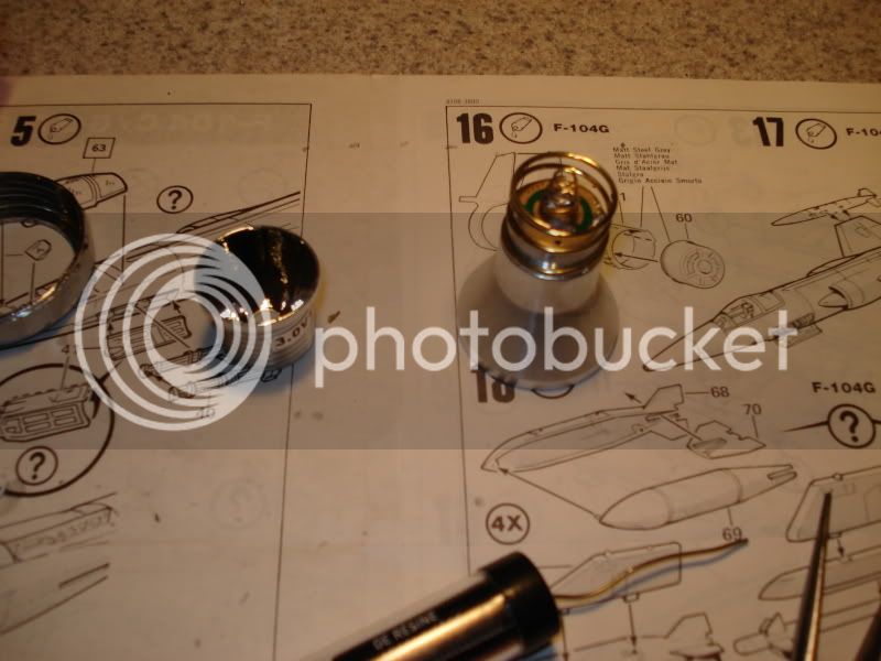

Well, the first thing I had to do was disassemble the original module. In this pic you can see the old 26mm reflector, and the guts transferred to the new reflector.
I had to install the 3-mode driver into the aluminum pill, and do a bit of destructive work to the old pill to get the star off without damaging it. Eventually it popped off, and I reinstalled it onto the new pill with some silicon thermal grease.

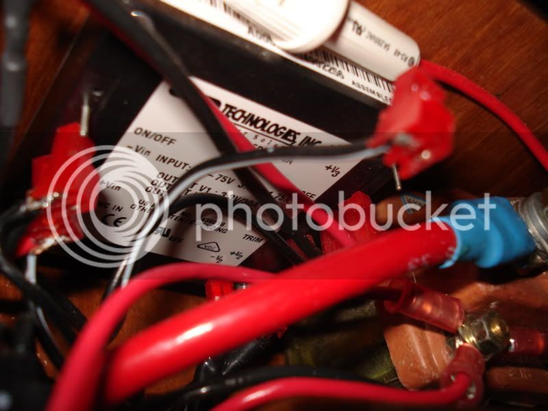

Here's my DC converter. It works great. The center channel is hard to see with all the plugs installed, but it supplies my LED with 3.3v.
