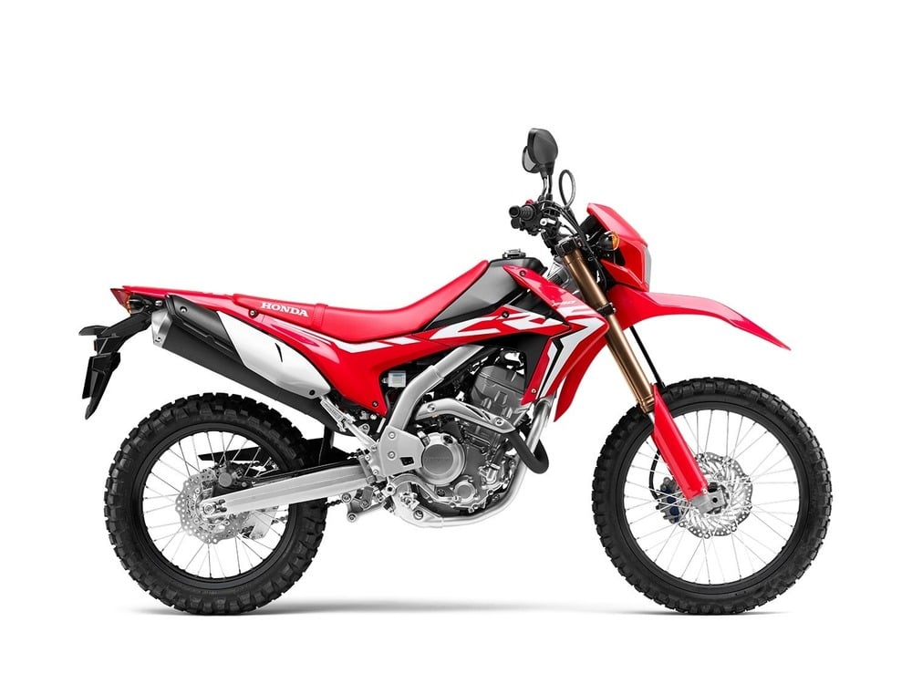

I sincerely doubt that Honda (or whoever makes their steel bike frames in asia) will ever sell the same chassis to other brands.
If you look at the CRF 250L (CR was the 2 stroke bike frame) it's clearly different.
What is probably true is that they can use the honda CRF plastics from the 250/450 R/F models.
