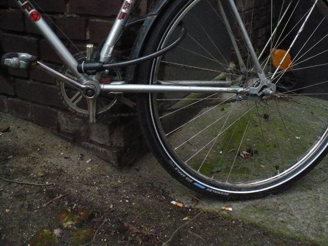

Sorry for the bad pic, I got no better:
the big challenge are the foot rests of the pillion. they have to be very stiff.maybe I should fasten them on the rear axle?? :?: :?: :?: :?:
or on the bottom bracket....
or maybe at the pipe between drivers saddle and bottom bracket?
or both... what do you think?

Somew universal Foot pegs for mopeds or motorcycles should work. they are meant to attach to the lower shock bolt, so usualy take a 10mm bolt, the same as a bike axle.

@ mabman: thx for the pics! This indeed gives me some ideas. The rear axle indeed is the best position. As is see, my idea of the plastic wheel cover isn't that good. I'll abandon it. Instead I will go for a smaller protection sheet around the passengers footrest, I don't like broken toes ;)

The standart moped footrest isn't what I wanna go for. I don't wanna pay anything for it, so a homemade alu alloy bracket will do the job for me (one piece sheet, combined with the foot protector sheet). But anyway thx for the idea, i will orientate my bracket on these footrests.
