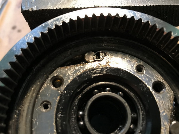

When I tried to setup my Q100C CST with Grin's Phaserunner(PR), I quickly destroyed the stock freewheel clutch springs while dialing in the motor after doing the PR software's autotune.
I think a lot of other people like this light rear hub motor, so I thought I'd post this info in case anyone else want to run it with a PR. Once its tuned up properly, you can squeeze a lot of torque and speed out of it with the PR. I will cover this in another thread as I am still fine tuning it.
Until the motor is tuned fairly well, the PR can cause some kind of feedback pulsing while trying to synchronize with the motor upon hitting the throttle. This can happen at reasonable power levels, without trying higher than recommend power or voltage levels.
Before I could continue dialing in my PR motor config, I had to upgrade the clutch springs.

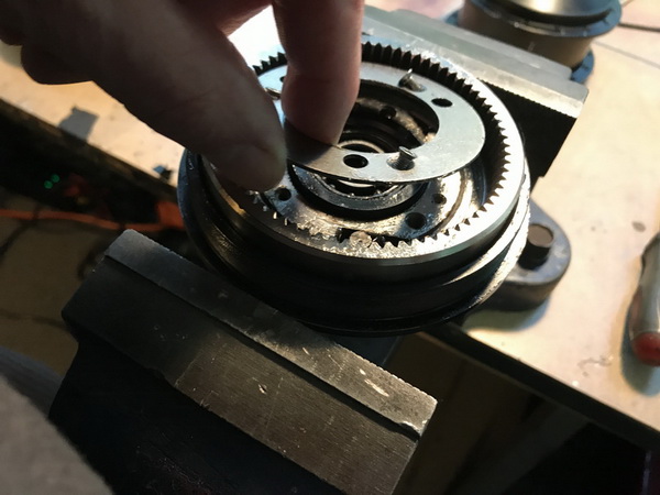

I don't show it above but to get to the springs you remove axle nuts on the cassette side, then tap the freehub and cap off. You don't need a lot of force. I bang the end of the axle lightly on the work bench and the cap pops of the motor internals.
Pictures of the clutch and spring are at the end of this.

At first it seems impossible to get the springs in while trying to compress them and get the little steel cylinder in place. With persistence it can be done with jewelers screwdrivers to compress the springs while inserting the cylinder. But there is a trick I learned where you first take the clutch cap off and then get the springs in place with the cylinders at their ends. Then you put the cap back on, rotate clockwise while pushing down hard on the cap. This will push the cylinders toward the springs and compress them, and then the cap will snap down to hold everything in place. Pictures to come as soon as I get one opened again.
I tried the 70231S first but for ride tests I could still hear what I though was a spring pinch grind noise when testing PR settings.
So for testing I decided to go with the MM-5's. They fit was a bit too tight/strong at their stock length, so I cut exactly 1 circular coil wind off each spring, ie. a 360 degree loop. This is still hard to freewheel but the wheel spinning easily breaks the clutch free. It is hard to break free by hand. And since these are the thickest springs available, they will be very pinch damage resistant.
So far these feel better as I went through more PR testing. There was a lot of resistance to rolling the wheel forward at first. This has loosened up a bit after a few hours of testing and riding and the wheel spins more freely now.
Once I am fully satisfied with the PR dialed in to the motor, I might switch back to the 70231S's and see if they work okay once the PR throttle feedback pulsing has been eliminated. Or perhaps the 70232S's, which are the same as the 70231S's, but a bit longer, so will be a bit stronger.
I'm not really sure if you need the strongest spring possible once the PR is dialed in. If not, the thinner wire diameter 70231S/70232S springs will provide less wheel rolling resistance, which will be possibly less boggy (like driving your car with the ebrake accidentally on a bit), and more efficient.
But I may find that the stronger MM-5's really are needed when running the Q100C CST at higher power levels. I'll update this post when I know more certainly.
When reassembling the clutch and sliding parts, I wanted some lubrication and rust protection, but not too slippery as to slip the clutch too easily.
I used a light coating of high temp silicone disk brake quite. Its is not too thick when heated up and not quite as slippery as synthetic or Teflon gear lubes. I think a light bike based bike lube like Tri-Flow would be too slippery as it has Teflon. 3-in-1 machine oil would probably be okay.
Whatever you use, you don't want too much. I made the mistake of using a liberal dose of Fluid-Film, and I was getting clutch slippage after.
