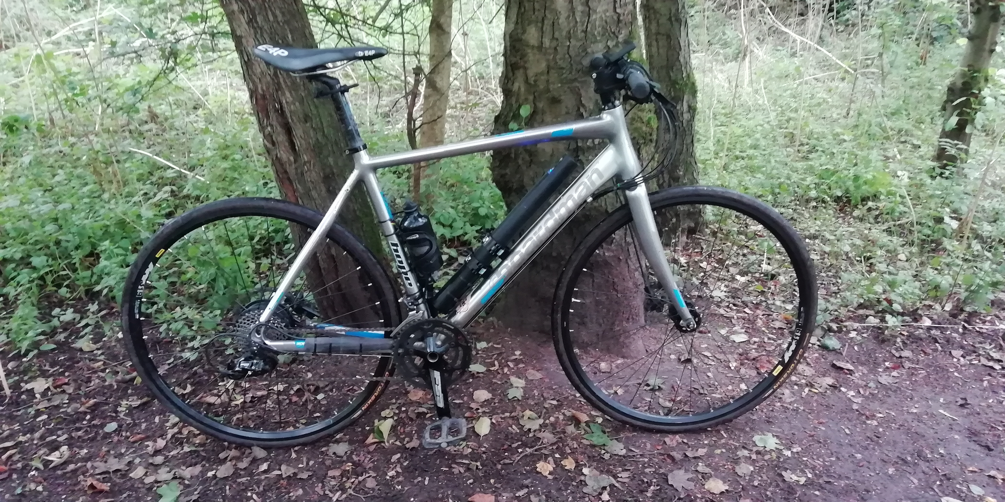

Just sharing my first creation.
2014 Boardman Pro Hybrid
36v 350w Motor

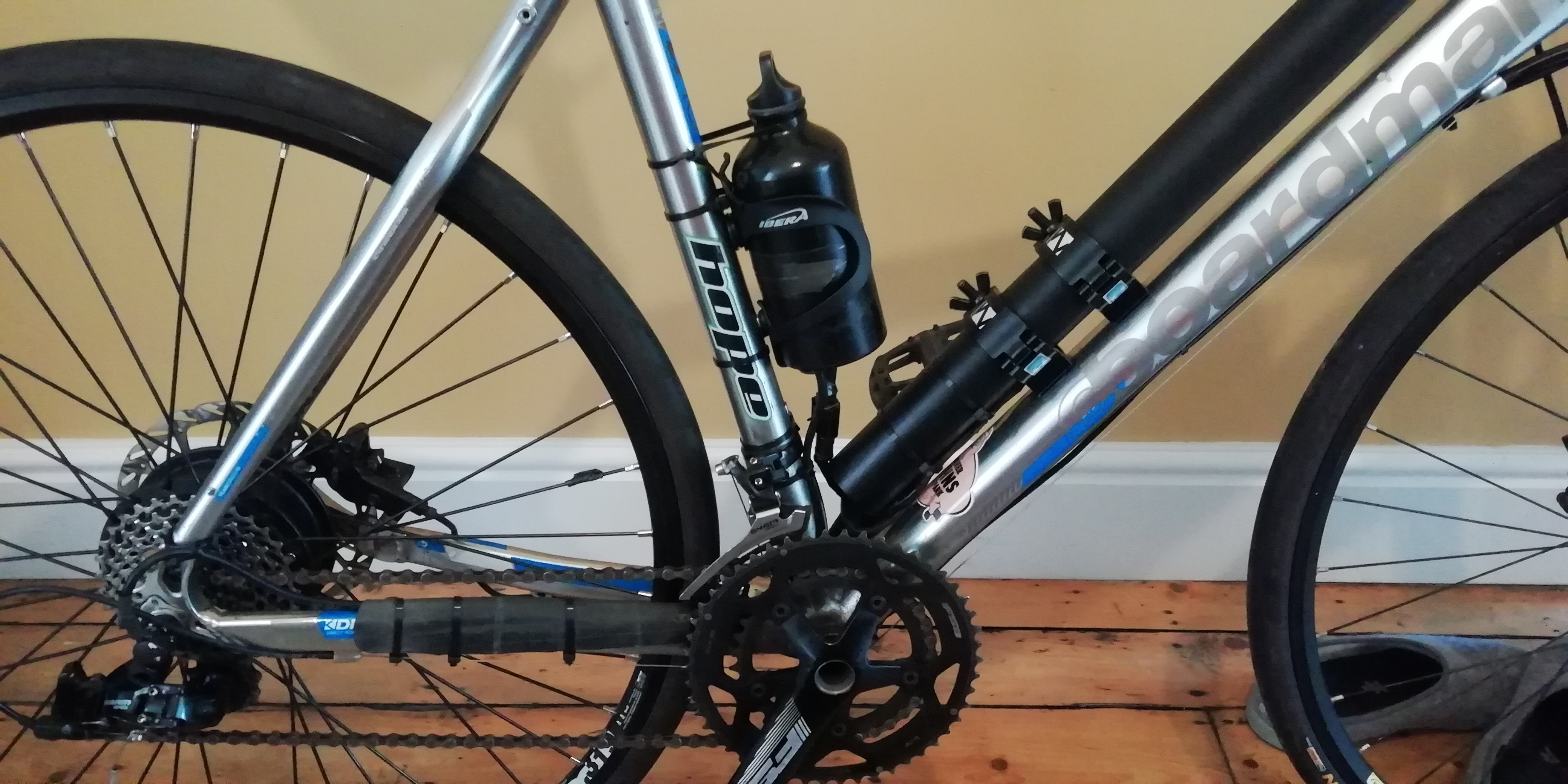

I built the rear wheel from scratch using a Mavic XM319 rim with x36 12g stainless steel spokes
upgraded to 185mm disc rotor to fit around the hub, however, had to grind away 2mm of my mounting bracket to gain some extra clearance on the frame

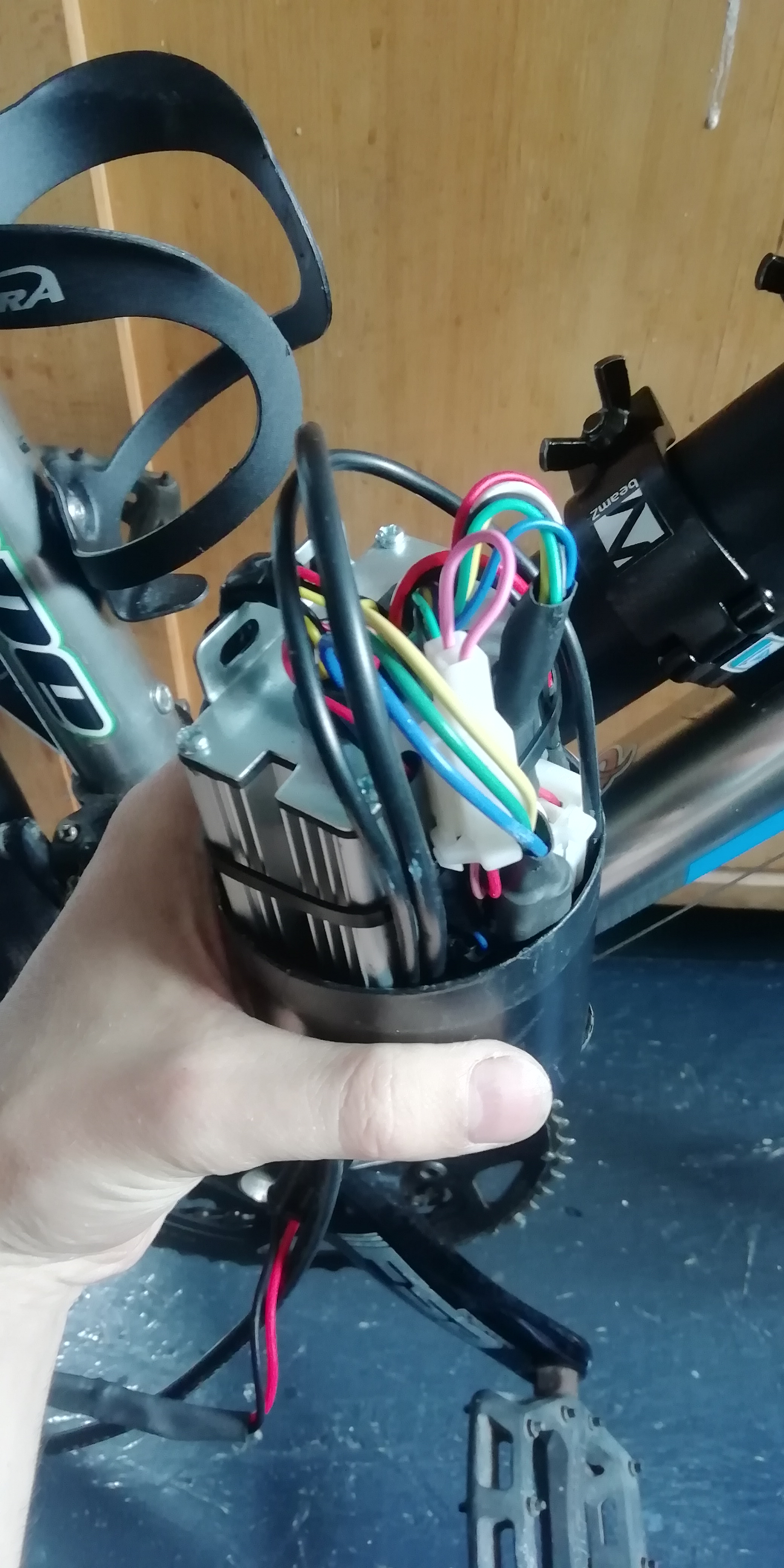

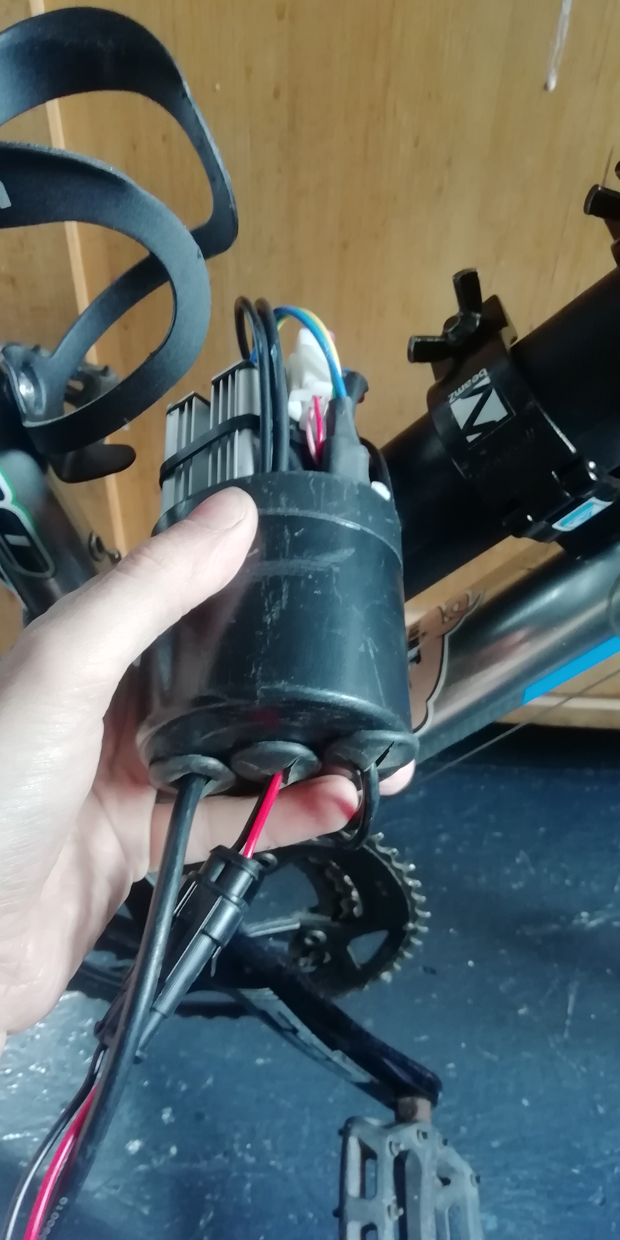

All the wiring just about fits into a small aluminium drinks bottle and the battery I've fixed to the frame using the bottle mounts and 50mm half coupler clamps.

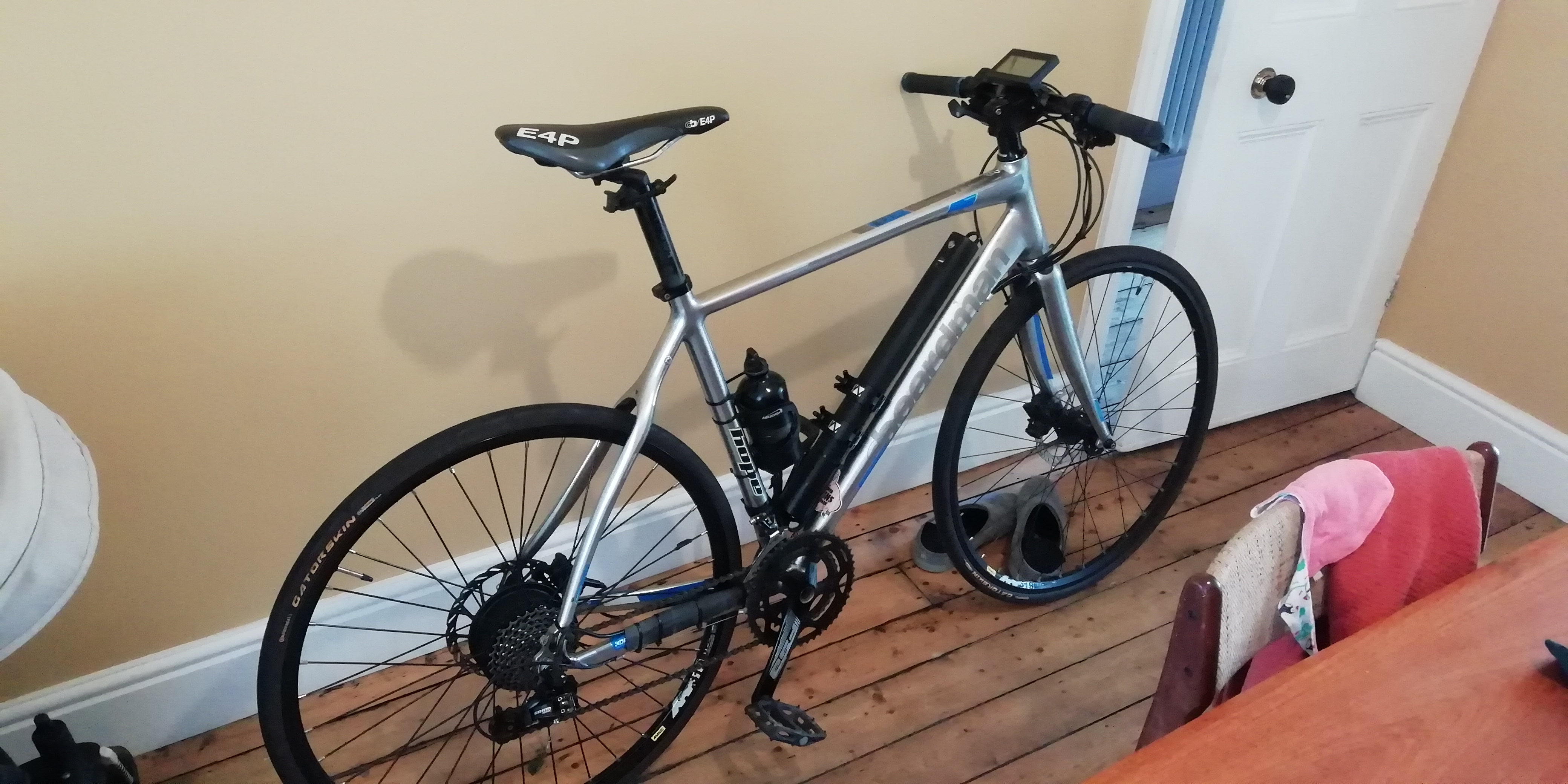

I've only ridden it a couple of miles and its fast.. under her own steam she'll do 24kph but with me peddling well let's just say it nippy.
Before ...
After ...
