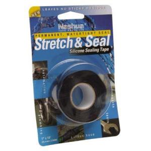

There's a kind of tape I buy at Home Depot that looks a lot like electrical tape, but is a little wider. It's in the same section that sells heating/ac stuff. Vents, ducts, etc. are there. Head to the place on the aisle right by where they sell stove-top vents and you'll find it. It's a blue package. The tape is black, about an inch wide, and has a film backing. You peel off the film and wrap it while stretching it to provide tension. It then forms essentially a plastic sleeve. I use it a lot for electric builds, but mostly to wrap cable or to cover some zipties. I don't think it has a ton of strength (not sure what your purpose is), but it's really meant to seal pipe. No heating or glue necessary, and it works amazingly well. It works so well, in fact, that you can't peel it back off. It's almost as if it melted into one thick sleeve. You have to tear or cut it away when you want to remove it.
good luck.
Here it is:
we used the tape in the op's post to protect the delicate coax cabling near the engine exhaust of jet fighters. (not really delicate but unable to withstand the heat)
It works very well for that purpose.
I've used it to repair leaking plumbing and as a damper between connections of structural materials but I wouldn't trust it for structural strength, although you can use it for your purposes as most of your joints don't require much strength- but expect to end up with a 'bulgey' joint
It will hold far longer than any duct tape I know of but any duct tape will have stronger adhesive (initially) and you would only need a couple of layers of duct tape to hold the plastic pipes together (less bulge)
