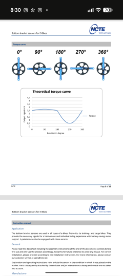

I've never used that torque sensor before, but the ones I have used are quite different. The voltage varies in mV, not full volts, and doesn't latch. Example graph from the datasheet of one I have used:
More like oscilloscope territory. I've heard some don't even output voltage, but rather just a tiny resistance change measured by a Wheatstone bridge.

Thanks, that seems to show a dip of 2v but as you say may be just that particular type of sensor. Have contacted madbicycle spares for advice as well. Seems a lack of info on testing Torque sensors generally.
