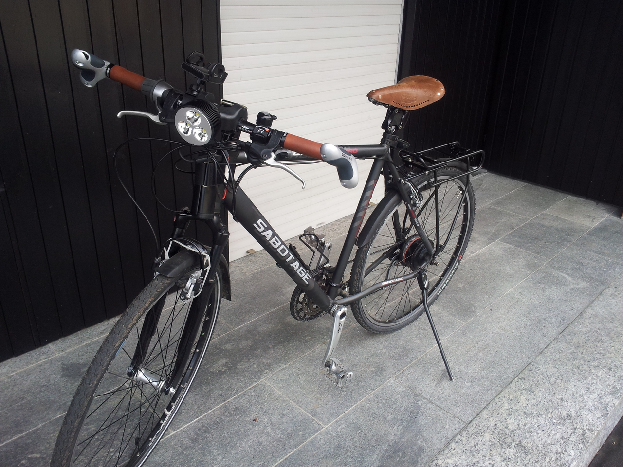

I built my first custom bike last year, after 15 years of not riding a bike at all, and something's still not right about it.
It's a 28" Trekking bike
with a NuVinci 360 (17 teeth) in the back
3x Shimano Deore XT crank wheel 26-32-48 teeth (so I get over 660% shifting range with the whole range usable)
Magura HS-11 front and back
LED lamp head with 3x Seouls P7 LEDs (a bit brighter than the light of an old car)
I also added a Thudbuster suspended seat post,
The aged Brooks saddle, that I just love
matching brown leather grips
Mirobar X1 barends (with integrated periscope-like mirrors)
I should maybe add, that I'm 175 pounds now. A year ago I was about 220.
I used to work out a lot, when I was younger, but got hardly any exercise. I'm untrained, when it comes to cycling.
On a 10 mile straight, on my bike I will deliver a sustained speed of 17-18 mph.
I would like to get an electric motor for the front wheel (so I can keep the NuVinci) that will raise my sustained top speed to 30mph. I'll get scared going faster than that. (Don't get me wrong. I have no problem with doing 175mph in an Audi A8L or 190mph in 911 turbo) but somehow doing much more than 30mph on a bike is outside of my comfort zone.
Also, here in the Bavarian forest we do have real hills that aren't just gently sloped. So to go up to my parents' house, I ride the bike up 2 thirds of the hill and then I usually opt for pushing as my thighs start burning. It would be kinda nice being able to go up those hills, too. By the way, I would love to have a range of 60-65 miles even after one year of using the battery.

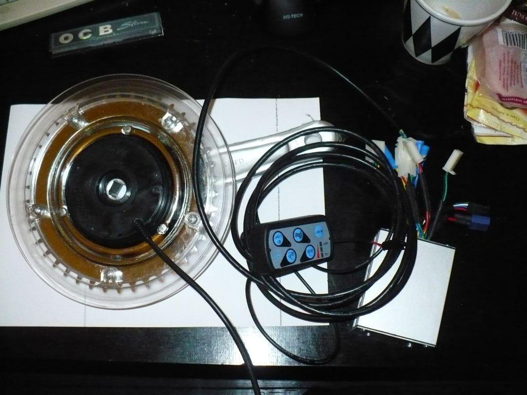

I got his one from bms battery, sadly the display is broken, so nothing works at all. I hope I get support from bms-battery to fix this. I will report on how it might work. I already enlarged my bottom bracket to a 135mm one for my tongxin midrive, now with the torque seonsor it will become very tight. Three chain rings are not impossible to build in, the bracket axle just have to be even wider, and you would get big problems with chain alignment. I guess this would look very funny.
Thats what I got from bms-bat:
If we look closer at the Thun X-Cell RT Sensor, we see that it can only measure the torque of the left pedal. That's very sad, but that cannot be changed :(
Not easy at all this topic... i hope to get this bms-bat sensor to work with an infineon controller.
