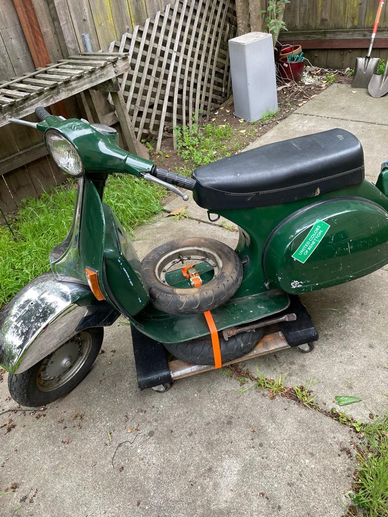

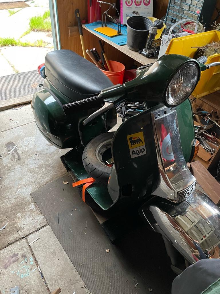

I found a P200E that didn't run, and another person wanted the engine, so it sounded like a perfect candidate for the build.
I'll try to post about the build experience and some lessons learned so far. This was an absolute joy to ride and was incredibly quick.

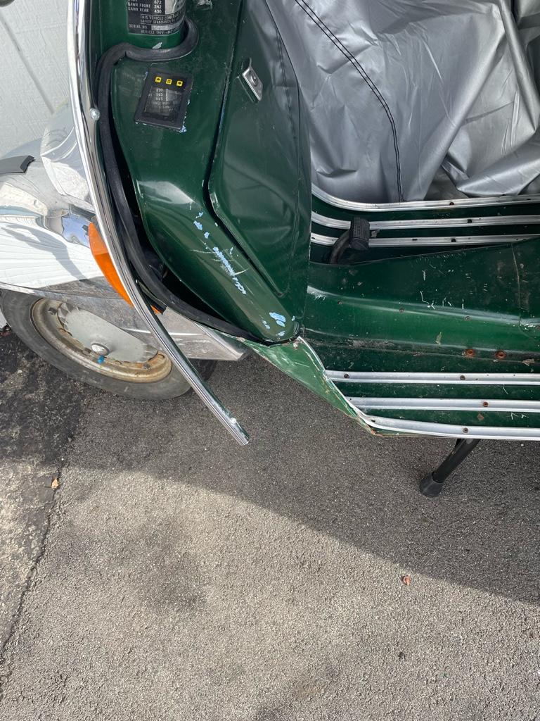

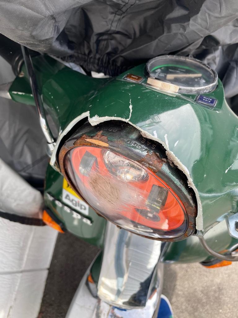

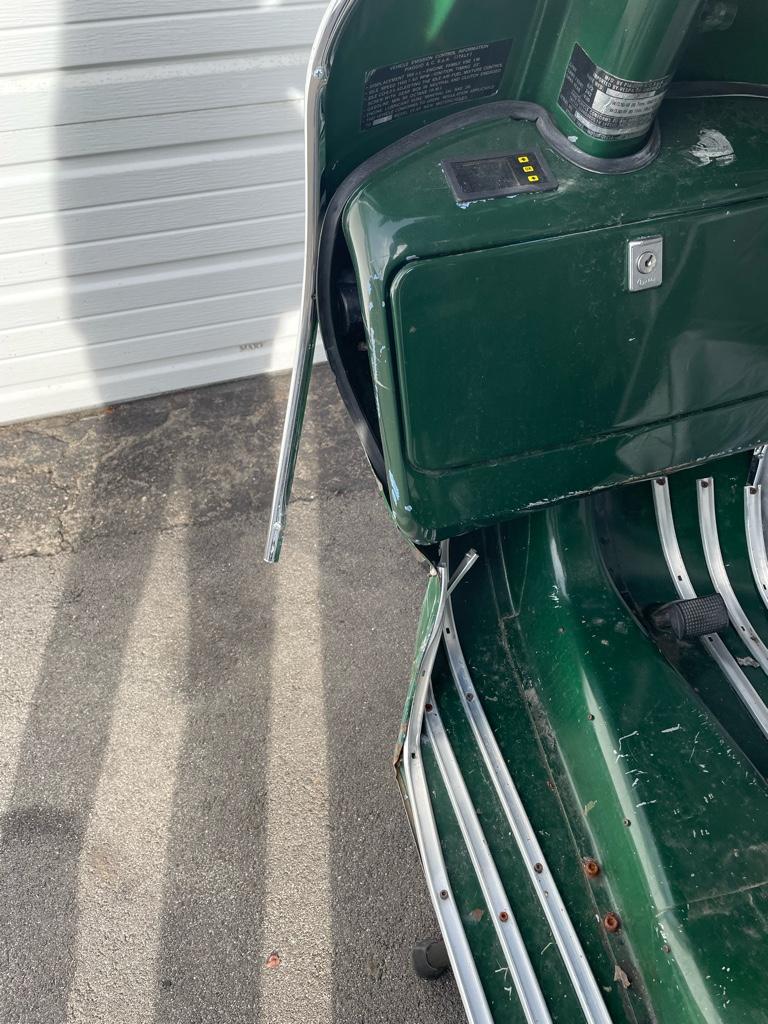

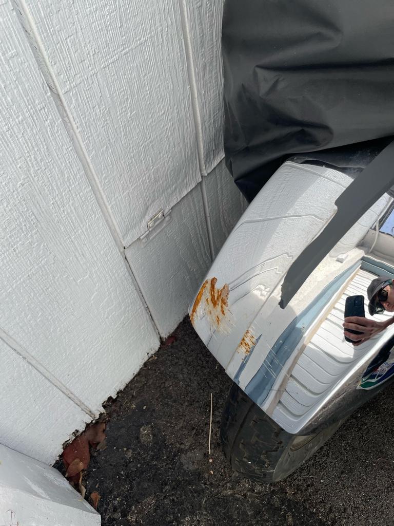

I had a pretty unfortunate situation on a test ride and the project is on hold for now.
A negligent driver hit me head on while making an illegal left turn. I was only going about 25 mph, but the Vespa and I both took some pretty bad damage.
