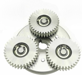

Long story short, I need the specs for a replacement planetary gearset for my bike. I don't have a gear puller yet to pull this stuff out and take a look so I was hoping someone could confirm this is what I need:
36T Nylon+Steel Planetary Gear Clutch Kit for Bafang 500W/750W Motors - 47.5x12mm Gear with 88mm Clutch Set
Color: Gear Clutch - Left
The motor cable exits from the left side of the bike.
I could also just swap the broken gears on motor 1. I would assume I would just order some 47.5x12mm 36T teeth for that repair.

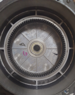

Random motor diagram:

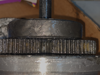

Top view of clutch pack on motor 1:
Side view:

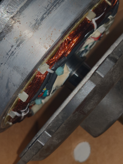

View of the windings of motor 1 (I don't have enough expertise to say if they're cooked or not:)

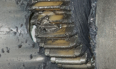

Shredded gears:
