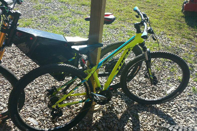

This will be a conversion of my wife's Trek Marlin 5, 13.5" frame, 650b wheels.
I've ordered a 1500 watt hub motor from Leili with the color TFT screen and RFID keys. My wife isn't interested in high speed, but wanted something so she could ride with me.
I'm somewhat concerned with battery and controller placement as there isn't much space in the triangle for 48V of hobbyking 16ah packs (3ea 4s packs). I'll probably fit it with a top tube pannier to house both batteries and controller.
Open to suggestions, especially from anyone who has converted such a small frame to electeic. I'll post more photos as parts start to arrive.
