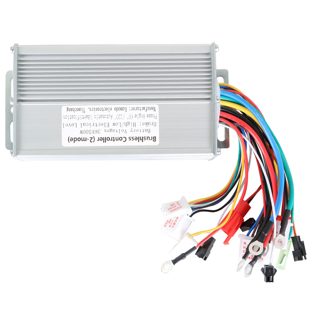

A programmable controller, for example:
Ebikes.ca phaserunner VESC with ebike control conversion board Random low to mid quality programmable controller
Phaserunner - Grin Products - Our Products
Single ubox Aluminum Lite controller 100V 100A based on VESC
36v 500w brushless motor speed controller for electric bikes scooters go karts   durable replacement with precision control   0
Obviously we cannot really tune a non-programmable controller. maybe you have power levels, but that isn't adequate to get a good time.
