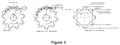

Inspired by bzhwindtalker:s great builds and the incredible power deliverance from the GNG 450 motor i'm aiming for a very simple setup.
The Specialized bighit will be used with the BB as a jackshaft, no pedals and footpegs a bit in an mx-style.
There will be a single reduction from motor to BB and another reduction from BB to derailleur.
55/11 at the motor and 34/9 from BB to cassette. (slowest gear)
GNG450 motor.
24S lipo. Lyen controller.
The round paper at the BB symbolizes the 55 sprocket.
