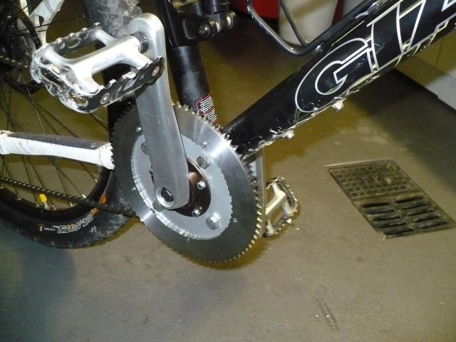

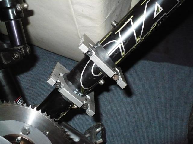

Postby crossbreak » Sun Nov 27, 2011 7:18 pm
frame mounts:
I used 10mm alu sheet, but I should have used 12mm. The screws arre all M6
The mounts can also be used as hub motor mounts. The width should then be 100mm, not 80mm.
pieces of bike tube portect the frame from scratches.

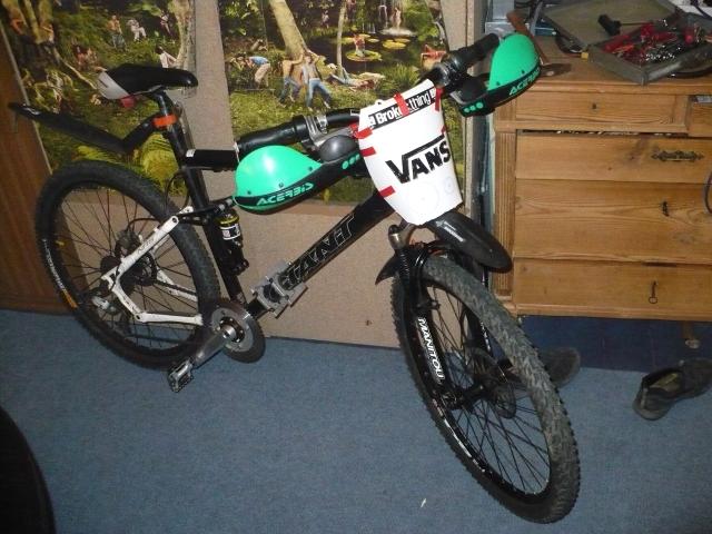

Postby crossbreak » Sun Dec 04, 2011 7:11 pm
the handguards are simply fastened by a drilled synthetic cork, pushed into the handle bar and then squeezed by an M5 screw. note that the aluminium bar at the side is homemade

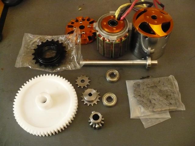

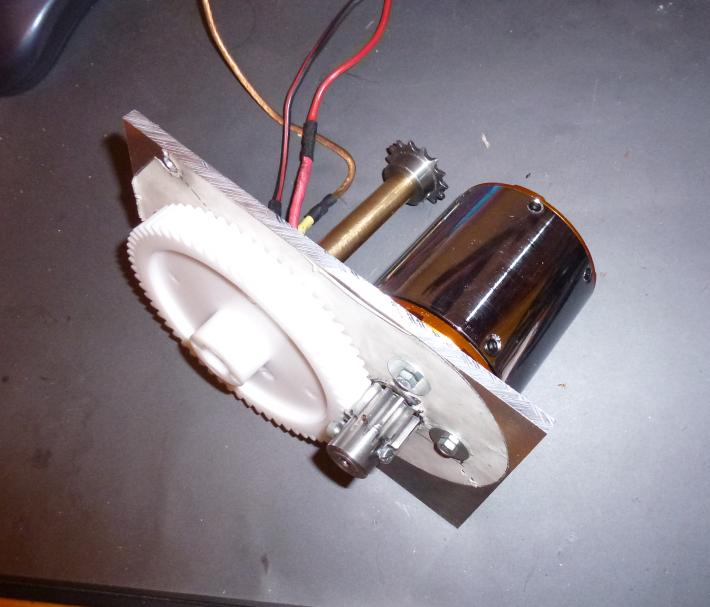

Postby crossbreak » Wed Dec 07, 2011 9:26 am
Hi sn0wchyld,
I didn't care much about the electrics yet. I designed the gearbox to last about 10NM at 4000rpm at the motor, thats about 4kW in short term, with steady load it should last about 3NM at the same speed, about 1.4kW. I hope that all of the chains and gears will last about 10.000 km or two years with good lubrication (including the final shift drive). Then they will be replaced all together.
The bike should not be faster than 35mph or 55km/h, to save battery capacity. Wind drag makes the most, which rises exponentially with speed.
The pinion gear is made of 11SMnPb30 Steel (not stainless), big one of casted polyoxymethylene (POM), their module is 2.
I will start with a sensorless 12-FET, 37V, 15amps (about 500W) with 10ah 10s2p LiPo. If that runs good, I want to increase it to 24-FET 48V, 100amps, 13S Lipo with 20ah and the same but then modded controller. I want to stay below 60V because of legal issues. I also don't like to add halls or optical sensors to the motor, but most likely I will have to.

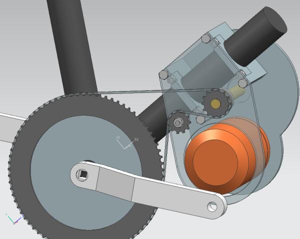

another concept with a gearless mini hub motor from conhis in china
the motor was simply added to the elongated drivechain. It pulls really hard whit a 16t sprocket (the 2mm alluminium bar to the front takes this load). The freewheel was just screwed on bsa-threads on the motor, but reversed. That way it drops out when the motor engages.
To prevent this, I screwed a plate at the end with three M3 screws, which worked really fine for normal riding. But when I rised the maxamps to 30, the screwes cracked during a hard bench test :( (full throttle, while spinning, full brake):
The coulor of my jeans has nothin to do with my political bias :D
Six will make the job I guess.
Sadly the enlacement angle of the pedal chainwheel is to small, thats why it slips when pedaling hard :( guess a enduro chainguide would solve this. The chain survives longest keeping 180 degrees at least.
It was nice to see how it performed, but it's sluggish at 36V compared to the 80-100. This one needs more voltage. But at more than 48V a 16t sprocket is too big, it would need another reduction stage. Otherwise its quiet and waterproof. The shaft is too long to simply put it in front of the bottom bracket, it would interfere with the crank arms. The shaft could be shortened if I could get it out. Has anyone ever disassembled a gearless motor? Can't see how this works, removing all of the screws doesn't help... what do I oversee :?:
[EDIT] I know now how to open up the motor. You need a puller. Watch a video about this, search for "hub motor dissasemble" [/EDIT]
BUT this motor is really load at low speeds and high torque. Thats why I sold it in the end.

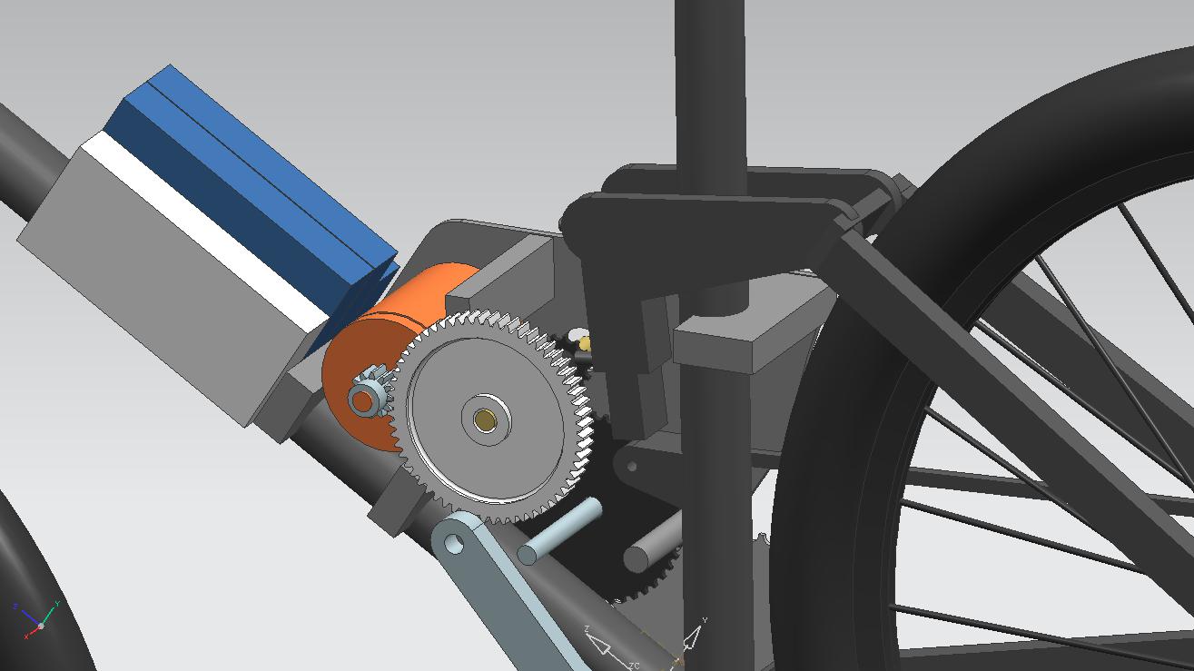

Postby crossbreak » Thu Jan 26, 2012 8:21 pm

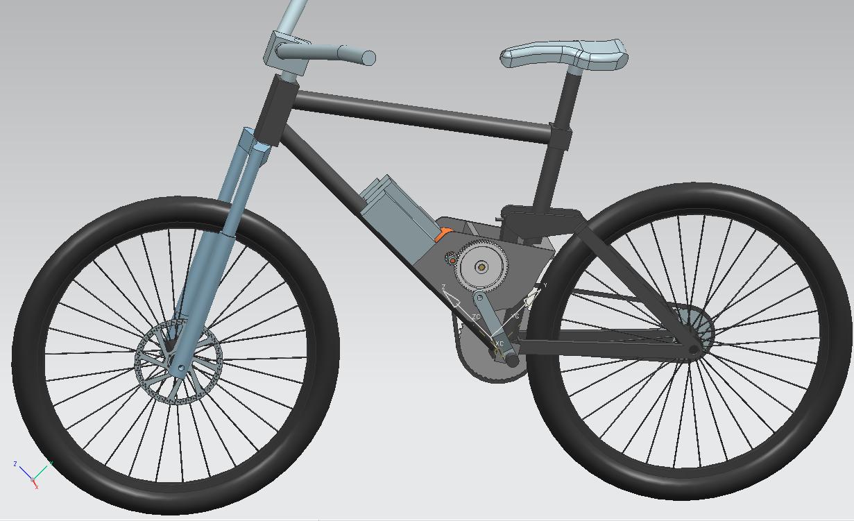

Another concept with the 80-100. It is calculated for 4KW @ 4000rpm peak and 2.5KW@ 3000rpm continous.
The chain drive won't survive this very long. That's what I'm researching about concepts with build in gearbox. ATM im thinking of an SRAM S7-Speed hub box build into the output axle of the final drive. This would reduce the tourque it has to handle by factor 2.5. CAD-Pics on that topic will follow soon.

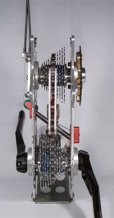

Another idea would be to integrate the shift chain into the gearbox like this phaser gearbox:
crossbreak

The 1KW for the nuvinci can be reread at their specs. But the 1KW is at 1000rpm. It should mean that it can last about 10Nm torque.
The Plastic Gear has 60 teeth, module M2 and can last 18Nm torque, the motor sprocket has 12T, that would be 18NM/60x12=3,6Nm at the motor. That is about 2.2KW continous power it will withstand.
If you want to go further you should just take a larger motor gear. but you have to keep in mind that you should get an over all ratio from the motor to the pedal cranks of about 6000/120=50 if you go for 48V and take the 130KV 80-100.

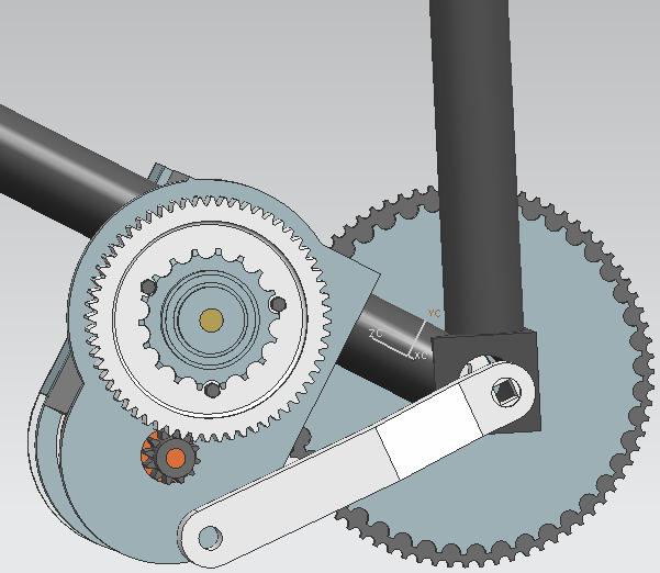

Postby crossbreak » Mon Jan 30, 2012 3:38 pm
The Phaser Gearbox won't work long because it has a 13tooth (or less) sprocket on the crank arm. Even a very light person will make it fail when it engages :(
primary reduction to a jackshaft? what do you think?
