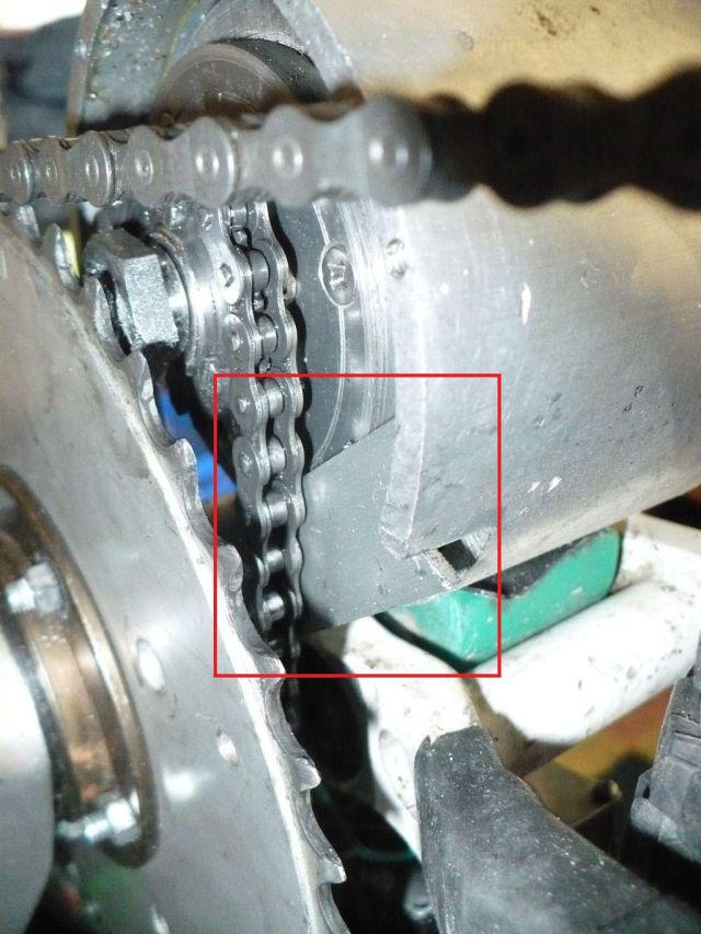

The mounts bend too much, thats why the chain makes noises and sporadicly jumped off. I fixed this problem by adding 2x20mm aluminium bars between the housing and the bracket to keep the distance when the motor pulls on the chain. It's a kind of a chain tensioner, it's not final, but it now works completely silent, the noise from the wheels is louder :D No cyclist or pedestrian I pass recognizes me first if I don't bell
another bar on the tension side of the chain:
The last problem to solve is the load on the front freewheel. It sometimes stalls, it''s bended to hard. the distance between it and the chain ring is too large (I marked it in the picture below). Another bearing between the shaft and the chainring could take this load (it's also shown in the cad picture below)
