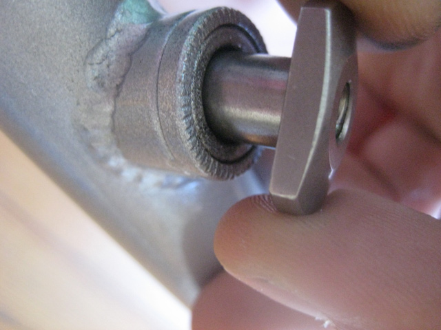

Okay, now let's talk about the dropout mounts.... hey, why are these bolts so loose? it's like they gave me metric bolts instead of american, or the bolts are 1-2mm too small.. they just rock around inside.
This insert that clamps to the dropouts is rather weak, also it is not wide enough and rocks around inside the xtracycle mount.... seems to have 1-2mm of motion as well.

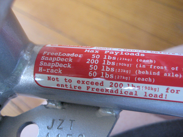

Max weight rating is 200lbs.
Now i know why so many people ( but not everyone ) complain about this being a flexy setup. All the hardware to attach it is the wrong size and loose as hell! This can be corrected with a little grinding, some new bolts, and some new nuts.

Summary: from an eBike perspective, i wouldn't trust this for higher speeds, but maybe 20mph or so would be just fine as a high torque, legal speed hauler. Even for normal usage, i'd replace a lot of the hardware.

WhoA! hold your horses, people. I was alerted to this thread by davec, who somehow got my private email and thought I'd be a good person to help resolve his issues. I'm a founder of Xtracycle, though I no longer work there, and I'm only getting into this discussion because it seems misinformed.
First, davec sent me the exchange he had with customer service at Xtracycle. It seemed to me that customer service certainly did care about his complaint and went to lengths to make sure nothing was wrong with his kit. Also, ultimately, they disagreed with his criticisms. They were friendly, and offered him remedies, including a complete refund. That's not poor customer service; it's the best you can expect. They didn't reply to his latest email yet, because it's the weekend. Be realistic folks, Xtracycle is a tiny company and they don't have 24/7 customer service.
As davec finally noted, the 5mm bolts are not axle bolts. In fact, you could say they are oversized for the job since they are doing the exact same work that a 3mm quick release skewer does: squeeze so that the 9mm "axle" stays in place. I do agree that the French Nut should fit snugly in the Boss Hog, and it has always been my experience that it does.
Neither the weight of the rider nor of the bicycle is taken by the front mounting bolt. The weight is taken by the bicycle's chainstay bridge, upon which the FreeRadical tongue rests. The bolt merely holds the tongue in place. Even if you assemble the FreeRadical with the Tongue under the chainstay bridge (rarely done, to affect geometry), the bolt is not in shear.
This hardware kit is the same one they've been using for 12 years. It's good stuff, mostly stainless. My band tours with up to 15 Xtracycles, for thousands of miles, with 200-pound bikes. Before this, I worked at Xtracycle for 9 years. I've NEVER seen one of the bolts break, and would never expect to: they're simply the right size for the job.
Also, to all the hand-wringing about flex: once you learn how to load (by keeping the load really tight and with the weight as far forward as possible) and ride (by moving your body instead of the bike) an Xtracycle, in my experience it's really a non-issue. That said, you might be served by a stiffer frame if you're looking to carry really big loads (350 pounds plus, including rider) all the time. The Yuba Mundo, the Sun Atlas Cargo, and to a lesser degree the Big Dummy all fit this bill.

All the fasteners you call "5mm" are 6mm in diameter. That size is, for instance, what holds a brake onto a bike. It's what holds a spendy Phil Wood hub onto its dropout. Used correctly, it's very strong.
Consider that a quick-release skewer is a 5mm fastener. So the bolts holding an Xtracycle Free Radical to the bike frame are much bigger in cross-sectional area than a QR skewer. And that "too loose" nut pulls itself into alignment when under fastener tension. How would a tighter-fitting hole help in that case, except to offer a way to jam up the fastener with even the slightest damage?
The "kickstand" joint on the Xtracycle is under compressive load and a little torsion. The bolt mostly serves as a positive locator and is under little stress.
Bolts must stretch when tightened, to maintain their preload. Too big a bolt can be as much of a problem as too small. It's clear from your comments about fastener size that you don't really understand how bolted joints work. They don't have any effect on the stiffness of the system unless they become loose, and they are more likely to become loose if they are too thick. If they are too thin, the symptom is that they can't be tightened enough to resist the applied forces without breakage or damage.
The Xtracycle design is developed and proven. My friend the late Val Kleitz used and abused his early Xtracycle until it broke, many times. Many of the upgrades he devised were incorporated into successive generations of Free Radicals. There are no shortcomings with the fastener kit, for the purposes of the average installation. An unusual bike frame might demand slight changes, but these should be undertaken with some sensitivity to the demands of the original design.
It is one of the faults of a newbie mechanical engineer or designer to make operating clearances too small. Oversizing fasteners is another characteristic novice mistake. The Xtracycle Free Radical has limitations, for sure, but they are the limitations of its frame, the frame it's attached to, and the wheel. The fasteners are not a limiting factor.
