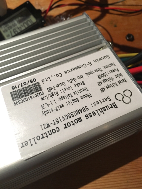

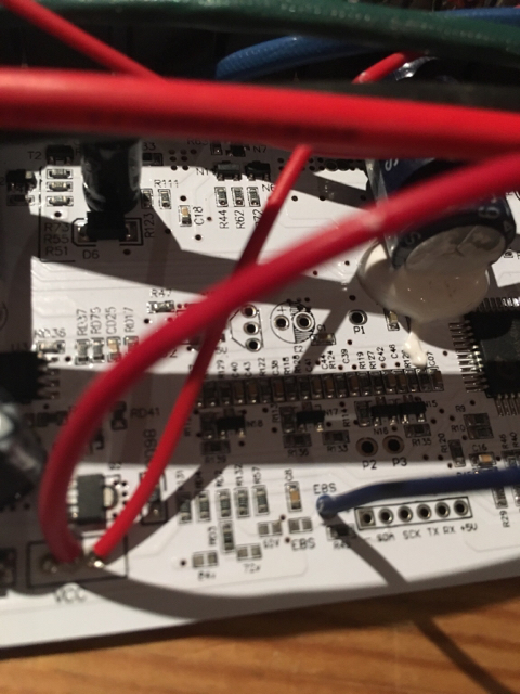

Same issue as others. No e abs on this particular 48v 1000w unit. I'm opening it up.
I tested mine (unloaded) at the weekend and got regen working. Connected the two blue wires together (e-abs?) and when you short the brake low wires it activates.
What voltage is your pack Samd?

My pack was 41.9v. 48v controller. Hmmm.
Yeah I had the blue wires connected and a brake switch on the low brake wires. There was 4.8v across the low brake wires. But nothing when I engaged the switch.
So what happens when you engage the brake? Just cuts power? No electronic braking? Try it with a more slightly charged pack and also unloaded.
Its actually doing nothing at all. Not even cutting the power. Weird.
I guess I could have a faulty switch. Will test again tonight.
Seems odd that there is 4.8v at the low brake terminals and nothing happens.
Have you tried shorting the two wires in the connector of the "brake low" connector instead of using the brake? That would help determine if the switch was faulty. very strange that it's not cutting power.
