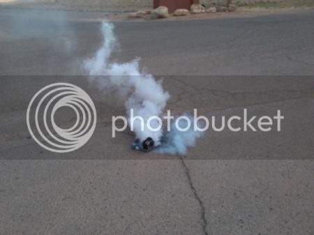

Lipo fire The senario:
I had a brand new tested Zippy from hobby king Lipo 3 series 5 AMPHR and a pair of Turnigy 4 series hardcase packs on my bike to use to power my headlights, I use vinyl/plastic front tube bags to hold the batteries. One side is mesh the other plastic and you can use a shower cap to cover it futher and protect it From rain. I did not take that extra precaution.
so I was riding to work very early in the morning, on my ebike, it started pouring rain, 20 minutes later i am almost at work and I hear PSSSSST, like a short and something evaporated, say a balance wire. I continue on another minute or two then my3 Series lipo burst into flames. It was seated near handle bar area in a bag
I was able to separate any of my other lipos from contributing to the fire.
I could not find the pack that night I went back in daylight to find the remains that I kicked into the wooded area.That’s when I noticed that I had hooked a fully charged brand new 3 series pack to the fully charged 4 series in parallel .
since I use power poles for everything. I make all my connections the night before, but apparently in my early morning haze I for got and thought I was hooking my light to a battery.
SO you can see I found the wires came off, melted off I guess , no sign of shorting there
I measured the voltages of the four series battery and all cells are at 3.10 volts.
I am concluding that it was an overcharged 3 series that caused the fire. The 4 series overcharged the 3 series and the 3 series had a thermal event.
I suppose there could have been a short , it was raining, but all the evidence is burnt up except the very intact power leads.
