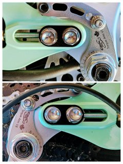

For the Grin fender eyelet torque arm mock-up, here's what I've cobbled up so far:
I notched the dropout slider to capture the torque arm bolt head:

That is an interesting looking dropout system. Apparently part of the derailleur hanger? Is it just an open slot in the plate? Does the plate slide F-R?

Hi @99t4 - this frameset has sliding rear dropouts from I.R.C., I think - they're similar to ones made by Paragon Machine Works. Similar, but not exactly the same dimensions 'cause that would be standardization, and we can't have that!
Sliding, rocker, or other interchangeable or replaceable dropouts (like Salsa's Alternator dropouts) allow for:
  • fixie or IGH chain or belt tensioning
  • QR, solid, or thru-axle compatibility
  • varying O.L.D. dimensions (to a slight degree)
I also suspect that the overall dropout area strength is increased, though this may be wishful thinking. All of my builds have replaceable dropouts. I like Salsa's design the most:

Can you remove the wheel without removing the axle nuts, by unbolting the dropouts, and disconnecting the derailleur from the hanger?
Not easily @E-HP, because the sliding dropouts won't just slide out rearward while still bolted to the motor - they're captured into the corresponding frame fixtures. I found and am using 19mm nuts now, doubled up - I'd just like to find better ones. Flats happen, often in a blistering sun, and I like to make it as easy and straight-forward as possible with as few fiddly bits as possible to drop/lose, etc.

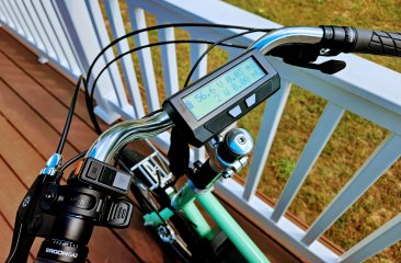

The bike's not done (when are they ever?), but today I took it out for a shakedown. I still need to order/install a second torque arm (P.S. - done), but I think otherwise, the bike is close.
Grin did a great job pre-configuring the Baserunner, and I only had to fiddle with a few things, such as units, wheel size, and the torque sensor.
It seemed quick, but I didn't have a GPS with me to calibrate against. It easily huffed up a short bastard hill near me (not the terrain I intend the bike for), and worked very well. the Cycle Analyst display will take some getting used to, compared to the other motor displays I have.
After the inaugural flight:
The bar cables are still a bit long, so I can try other bars & stems.

CA hanging in the breeze:

Looks great. Regarding the "small mechanical rear brake" -- that's fine, just turn on regen :)
You've got the direct drive, the Baserunner/CA combo means you can turn on the "if brakes are active, throttle is now proportional regen" mode which is fantastic. You can also try out "pedal backwards to engage and modulate regen" which I haven't tried, but seems kinda fun.
Thanks @chuyskywalker - Grin turned on regen, and I saw the message pop up on the display when I braked - a first for me, being a mid-drive owner/rider mostly. I didn't know about the backpedaling trick - thanks!
