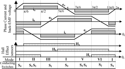

BLDC motor voltage (back EMF), phase current, and hall sensor waveforms:

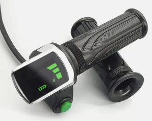

Throttles:
There are two common types of throttles are used for ebike applications; Hall Sensor based and Potentiometer based. The Hall sensor based throttle are by far the most common, and come in various configurations including full twist, half twist, thumb, and finger or lever styles. Note: In addition to the Hall Sensor and Potentiometer based throttle that output analog voltage signals, there are also digital signal output throttles. These throttle require a matching controller that can accept a digital signal and are mainly used with stand up scooter applications.​
The majority of controllers have a specified range of voltages that correspond to zero through full throttle. This range frequently appears on the label of the controller. Hall based throttles may cover a slightly broader range in order to be cover the full throttle range, while accounting for variances in the valid operating range of different controllers. Using DIY modifications, a throttle can be tuned to more closely match the controller, improving throttle feel and control. by removing dead bands in the lower and upper range of the throttle. Many potentiometer based throttles will require the addition of one or more resistors in order to be compatible with expected voltage range of the controller.​
Note: The connection between the controller and a Hall or Potentiometer based throttle requires 3 conductors; a 5V source, Ground, and Throttle signal. If a "throttle" has additional conductors, it would be because the "throttle" may have additional functions and buttons, such as ignition, to turn the controller on/off, or a meter or display, etc., integrated into the throttle housing.​

Throttle: 3 conductors - GND, 5V, signal​
Some throttle units have other functions like controller on/off or voltage displays, so those throttles will have 2 or 3 additional conductors, in addition to the three used for throttle.​
