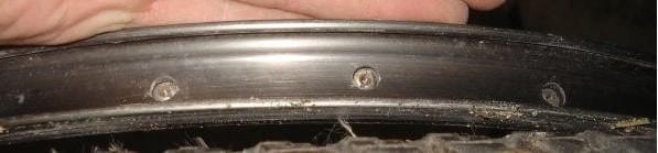

The trip itself was interesting and fun, although it was difficult at times to keep from nodding off (I knew if I did I'd feel worse than if I just stayed awake, as I'd only gotten an hour and a half or so of sleep). On the way, I was relacing Evoforce's main bike wheel into a new rim, which had a pretty destroyed rim that I wouldn't have wanted to let anyone ride on. The lacing went well enough, but with the tire and tube sitting upright on the floor in front of the seats we were in, I somehow managed to drop one of the old spokes in there which neither of us noticed as we put the wheel back together later, and it gave him a flat we didn't really have time to fix, essentially putting his main bike out of the race.
