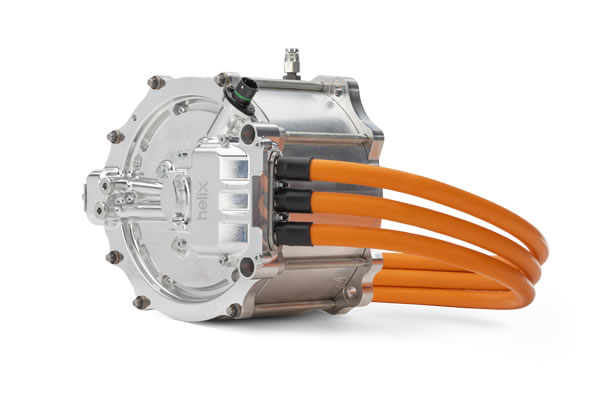

What's up Endless Sphere, we’re SPARK Electric Racing from the University of Michigan and we build electric motorcycles. We are in the midst of a new build and as we shift from design to manufacturing, we want to share our journey. For the past year, our team of about 50 students has been designing a bike that we hope to race in Moto America and maybe the Isle of Man if they ever bring back the tt zero. The performance we are shooting for is pretty nutty.
Here are the Specs.
Motor: 200 kW, 19,000 rpm Helix SPC 177-79.
Controller: Cascadia CM200
Battery: Custom-built 186S 8P pack with Samsung 50S 21700. 25 kWh 800 V 400 A.
Frame and Swingarm: Fully custom design, low-pressure cast aluminum with 3D printed sand mold.

Looks impressive, but what is your thought on the battery?
Do you mean that you will draw 50A on each cell? (8p, 400A)
Isnt the 35A max already probably on the high side?
Good catch! We actually ordered a few samples of the 50S cells and did a bench test on a cycler where we simulated a race based on telemetry data from the Isle of Man. We were pushing 50 amps through the cell in short bursts with no problem towards the bottom of the discharge when we needed to make up for power.

These motors looked real nice, I suppose they have a substantial price tag as well?
Substantial would be an understatement. If we manage to get our hands on it, it would likely be on the order of 20,000 to 30,000 USD. Haven't really been able to get an exact quote from them and haven't heard of any other small teams using them but we're in conversation. The only thing we have seen is Triumph doing the TE1 prototype using them.

Very interested in your controller and BMS choices with a battery voltage that high. Presumably you'll be building those components from scratch?
BMS is going to be semi-custom. For the controller, we are going with an off-the-shelf Cascadia CM200 to start with and maybe look into a custom design for a later iteration. Our electrical team already has their hands full with the BMS. The plan is to repackage existing evaluation board designs from TI and disperse those around the modules for different 16S groups. Kind of a huge undertaking with so many batteries as you can imagine.
