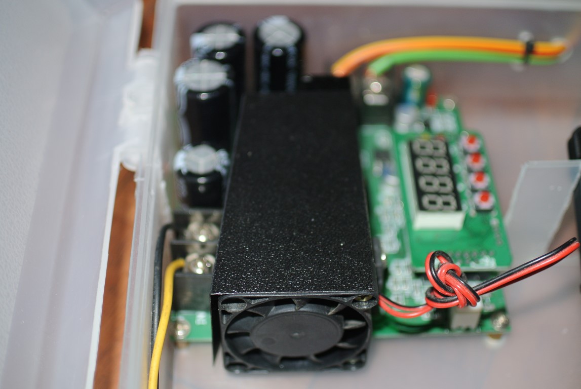

Too late, I already ordered one... Was in a hurry because I'm currently using a 12V telecom PSU, which means having to turn the current way down on the dc-dc converter to avoid overheating it and consequently painfully slow charging.
Looks good OC...
Looks pretty neat - You'll be using the built in fan for cooling ? I'd expect it to be enough, it can pull cold air in by sealing the lid round a fan 'hole' then put some exit holes over by the boost converter? Do keep an eye on temperatures, if you just shut the box as is it would probably get hot enough in there to start melting the box...
