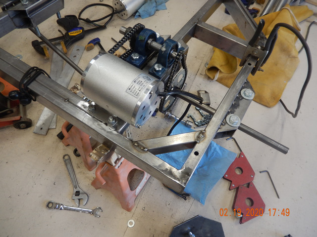

progress on the chain drive system moves forward.
The body has been restricting my movements and ability to see well enough to weld.
So this morning, off it came. (A design element :D)
MUCH easier. I was able to see much better, and getting into and out of position to work,
will greatly ease those parts, that aren't wanting to cooperate anymore.

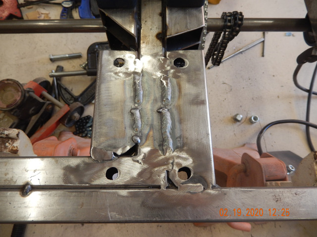

Got the motor mounts welded in and bolt holes drilled.
Bottom needs welding, but that will come later.

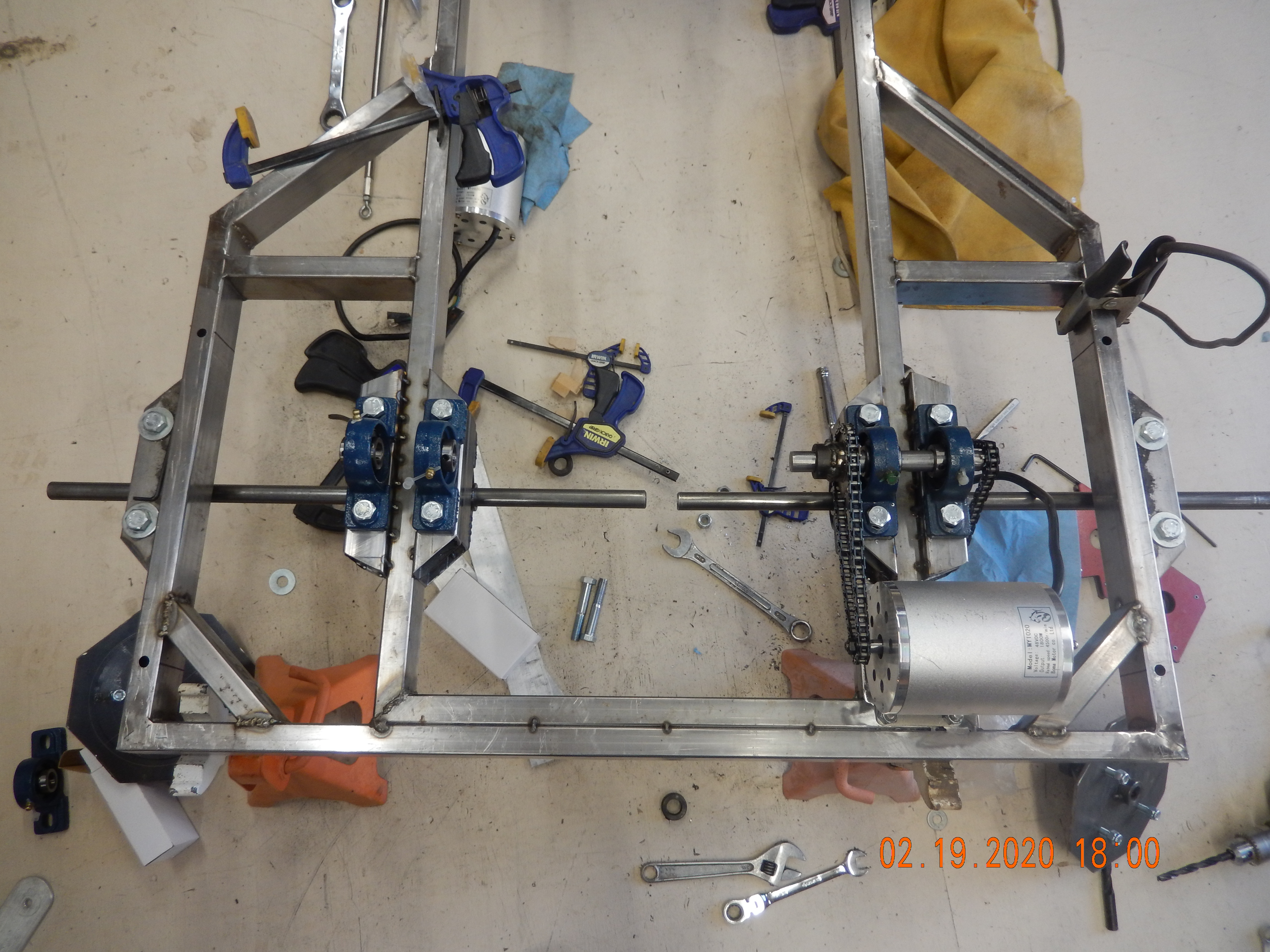

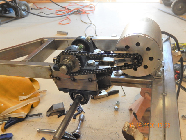

After some modification of the 'bicycle chain breaker', I am able to break the chain apart.
Still I must find one suitable for this heavier T8F chain.
So it's tighten up, then tidy up, and move on to the second jack shaft installation.
Then maybe I will look into wiring it up, for a function test.
Ran out of (or can't find) any more 3/8" bolts or threaded rod to make more.
Chains are made to length, and installed, and are near perfect for tension, as they sit.

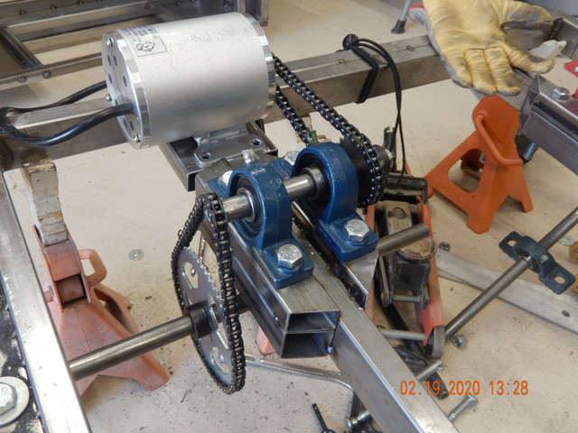

Chain Tension Adjustments
There are elongated slots, in the pillow blocks, forward/backward, for the motor to JS chain.
The PB holes are centered as you see in the photo. The chain is taut at this point.
For the JS to axle, I will use shims, under the pillow blocks to lift/tighten, the vertical chain.
An equal amount/thickness for both pillow blocks, thus keeping the JS axle running straight.

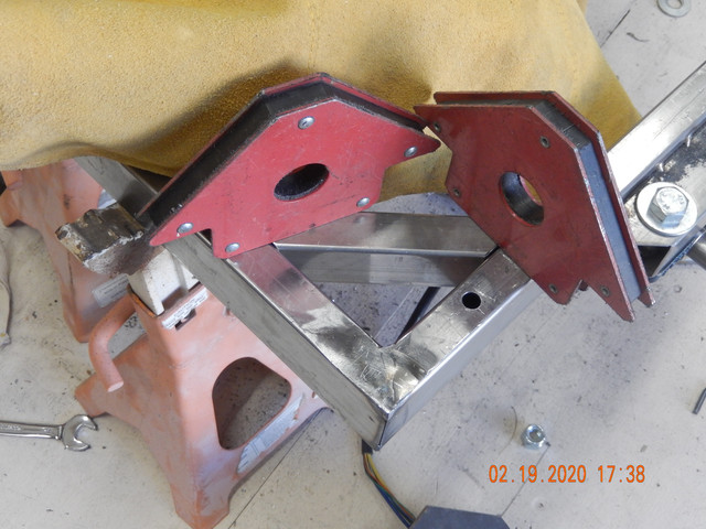

But while I (was) waiting for them, I made a couple of corner braces, for the rear of the frame.
With my motor and gears/chain, securely protected, I proceeded to weld the braces in.

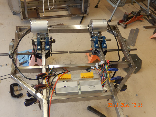

I had no sooner finished making the supports for the new pillow blocks, when I took a short break and discovered they had arrived.
So tomorrow, the plan is to make two motor mounts, have some coffee, drill some holes, have some coffee, make JS axle, have some coffee, have a nap, have some coffee, shorten a couple of chains, have some coffee. And while I'm having coffee, I will think about what to do before .. I have my next coffee.
In case anyone missed ...'the change'...I reversed the motor orientation.

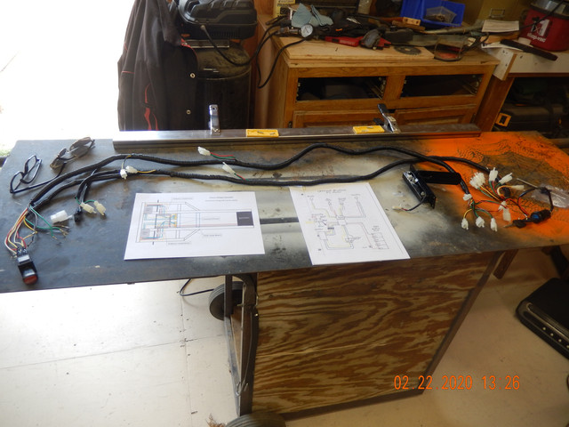

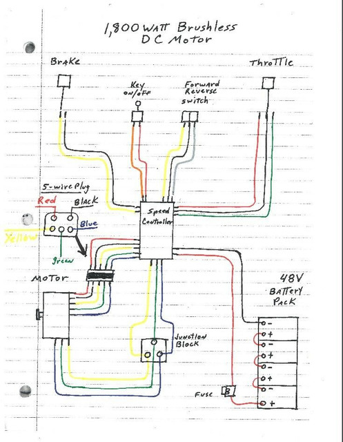

This morning before going out, and while my brain cells are in the mood, I worked on the wiring. (power only)
I needed to take the schematic that was supplied, and make it work with my two motor, two controller setup.
The idea here, is to gain understanding of how and where things will/may go, and what gets connected to what,
with out setting my shop on fire, or toasting any components.
Below is the schematic supplied with my motors.
I'm not including any accessory wiring in this exercise.
One thing that will be important is to have a very low resistance connection between the two controller B- connections. Use heavy wire and keep it as short as practical. This is because you are going to share the throttle between the two and any voltage difference can affect the throttle signal. Your drawing looks OK.
I'm not sure what you are referring to here...between the two ( controller B-) connections.

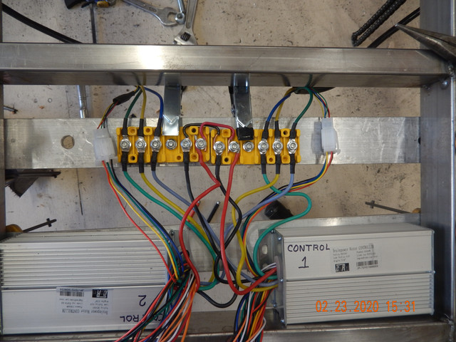

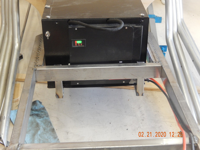

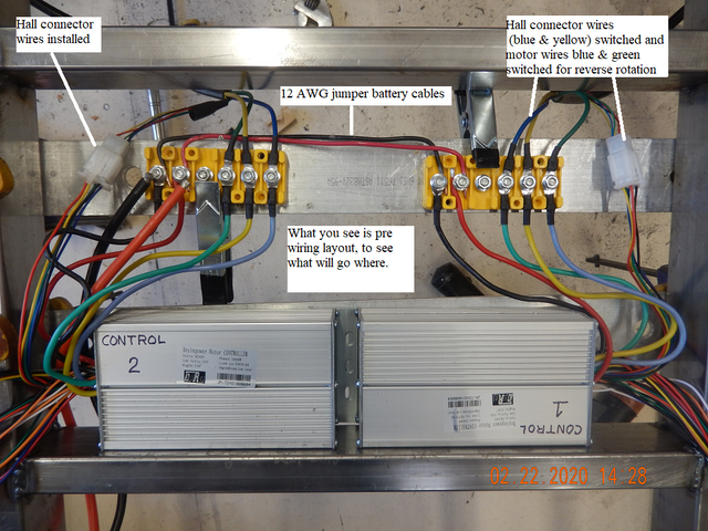

This mornings work
Installed the two cross pieces, and found a great place for the controllers, and terminal blocks.
I'll enclose the bottom, and have a vented top.
This all I have to monitor with at the moment
Turned cooler, wind chill factor, threat of rain, and windy. Time to work inside.
Trying to make sense of all the wires and connectors.
They're not all marked, so there is a bit of a hunt and peck trying to find what goes with what.
The controllers are marked, so that helps. But not all color coding is the same.
I may have to unwrap the wire harness, as it isn't really setup for my application.
I've marked my motors, so I won't loose track, of which is which....:D

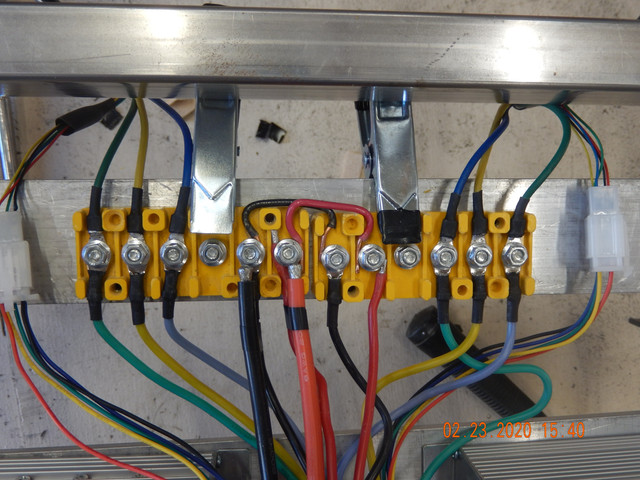

Preliminary setup. Still need to figure out how the wiring harness is going to work into this.
With what I have connected so far, (please correct me if I'm incorrect) in my wiring.
I think that all that is needed for just a motor function test,
is to energize the two battery cables, and see if the sparks fly. 😬
Or maybe just stick'em on there.
I'd be using the battery circuit breaker for a switch.
And yes I know the battery cables do not have ring terminals...YET !
fwiw, i'd mark the motors and controllers (and any other dual parts) as "left" and "right", so they can all be easily kept track of without a reference chart for which is which. ;)
for the battery wiring, i would use the heaviest gauge you have available; it helps prevent voltage drop between battery and controllers, *and* from differences in current flow between controllers causing ground to rise on one vs the other, relative to battery ground, and throttle ground / etc. I think i'm using 8g on my sb cruiser trike, might be 10g though.
there is good info on 2wd wiring systems over in teklektik's yuba mundo cargo bike thread.

I need some clarification what is meant by; between the two controller B- connections.
What are, ( B- connections) ?
Are you by any chance referring to the jumper wire from one terminal block to the other?
that, and the connection to the negative of the battery. (battery negative = b-, battery postive = b+)
i'd do the positive wires in the same gauge, just because. ;)
Buying a converter is not a problem, I just need some understanding, why?
I thought the controller did the same thing?
If not, why are all those wires coming out of it? :)
hte controller converts battery power into motor power.
if you need power for lights and stuff, that's a separate thing, and either uses a separate battery (like i do on my sb cruiser trike), or a dc-dc to convert the higher traction battery voltage down to the 13.6-14.4v that automotive lighting and accessories use. (you don't want just plain 12.0v, as it will mean dimmer lights, etc., so make sure you get one that's at least 13.6v. some automotive-level dc-dcs are marked as 12v covnerters, but have a voltage spec that's the higher voltage range, and that's what you're after. (or one that's adjustable up to that). i recommend the ones taht are potted and sealed, because while that makes them essentially unrepariable, it also makes them less likely to need repair from environmental conditions.

It would be best if the main negative wires were connected directly to each other on the terminal block. This also goes to the battery. If the negative battery connection between the two controllers gets loose or has too much resistance many bad things can happen.
I would flip the controllers around so the wire ends face each other but either way can work fine.
Hows this? Don't look at the connections, this is just to see what's what.
Trying to place 3 rings on one terminal is iffy, at the moment. The studs are very short. Barely over the depth of the nut.
I think the 'rings' would fit, but the crimped portion makes it. 'iffy'.
I checked the wire size from the controller, and they measure 12 gauge, (with solder on it), so maybe it's only 14.
Looking at it in the picture, makes me think maybe. When I go back out, I will give it a try, with the two smaller wires, (12 AWG & 14 AWG) on one side, and the 8 AWG on the other.
you could take one of the short studs out, and replace it with a longer bolt. (making sure to insulate between it and the frame).
amberwolf said:
I'm not sure, but I think those studs are molded in. So there is a possibility there may be breakage. The block feels like pot metal. It's not plastic. Maybe aluminum. I'll check it with a magnet tomorrow.
At $16.00 bucks a pop, I'd sooner not break one.
However I did try to place three rings on and it didn't work. The ring end I have for the 8 AWG wire is thick,
so it takes up the space of at least two of the others.
I can make a stud, connector/extender, using 2-3 nuts and a longer stud.
Or I can just use two jump wires as I originally had. If so, I would put the battery leads,
separate from the controller leads. And double up on the controller leads. (2 x Black) & (2 x Red). All will fit then.
they probably are molded in; you'd likely have to drill it out in a press to prevent breaking the plastic block. it's probably easier to just use two studs right next to each other for each of the batteyr connections, to keep the interconnect between them a very very short U.
it can't be metal, or it would conduct between the studs. ;)
i don't know which plastic it's made from, but it'll be some high density stuff.
