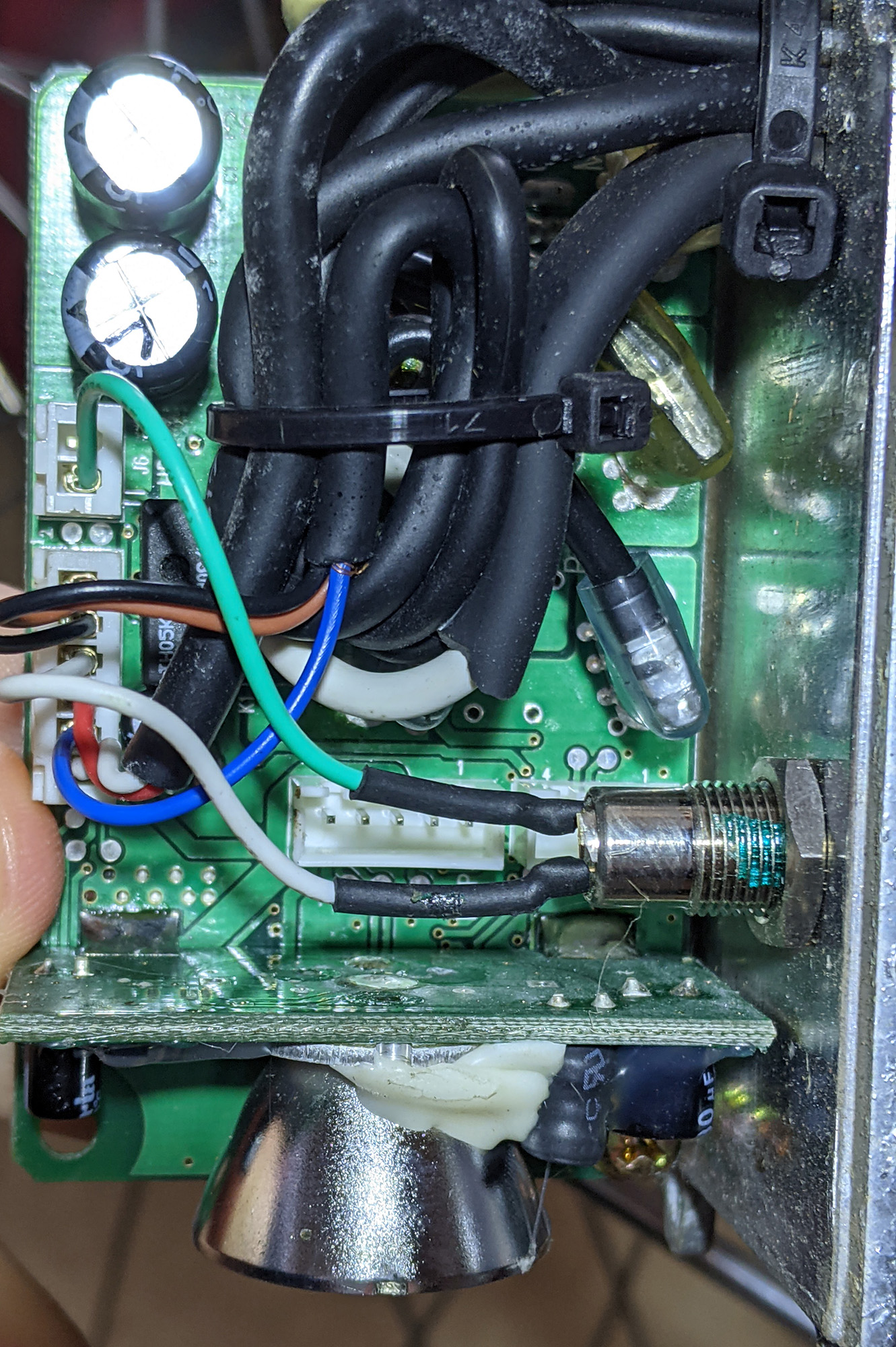

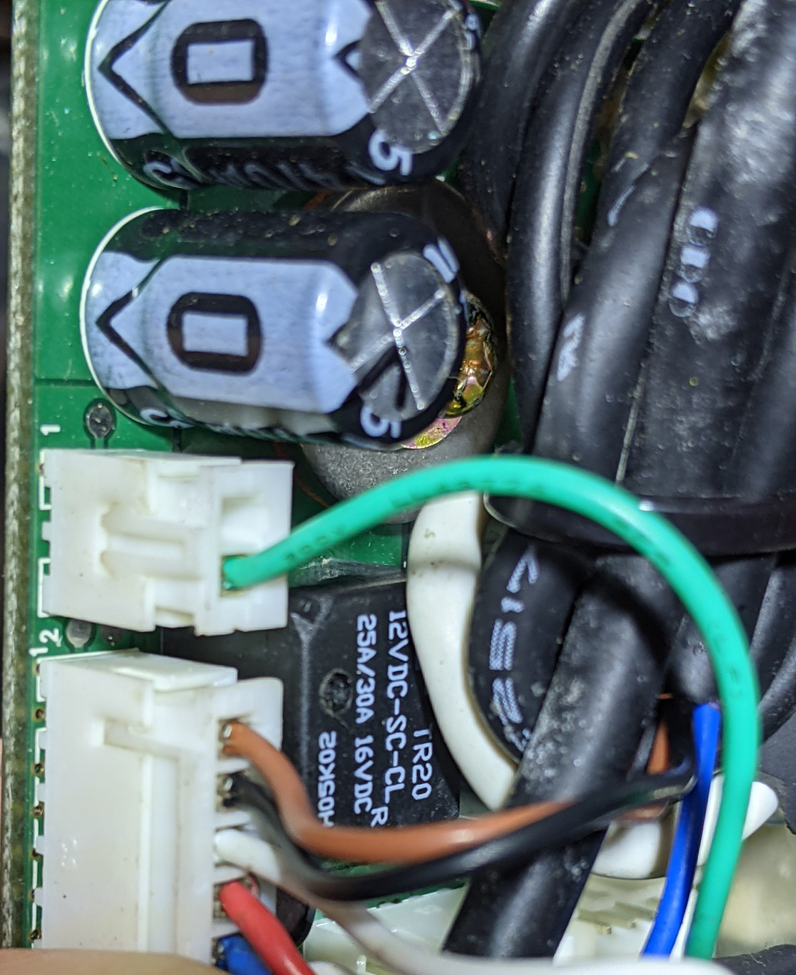

I just took apart the controller and it has caps rated at 35v but reveals the motor is brushed - 2 wires going to motor and a small relay that you can hear click in when you apply throttle and it drops out a couple of seconds after you stop throttle. It has some semiconductors on the back heatsink so what purpose is the relay?
http://www.tti.com.tw/en/relay/Automotive-tr20.cfm
12V coil. 25A/30A 16VDC
The controller appears to have LVC at 21.0v
It has;
green - throttle button.
brown/black/blue - pedal sensor
red/white - brake switches
