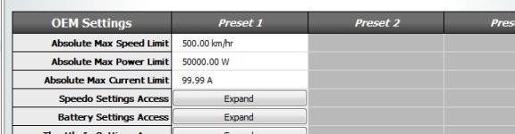

Dartman said:
What I like to know... Justin or or someone else!
(8) 8235 - (New) Wheel Torque Sensor PAS Option
This change affects the eeprom configuration with the addition of new
parameters and removal of the 'Absolute Max Current Limit' OEM setting. Firmware
updates will set these parameters to defaults.
How much is default Absolute Max Current Limit???
One trick is that you can see the default for any setting with the setup utility software just be creating a "New Setup" and choose the appropriate firmware version then scroll down to the setting of interest. The values in the SU software are the same as what is flashed by default on the CA
In this case you can see that it was defaulted at 99.99A (for standard range mode, or 999.9A for higher range mode.)

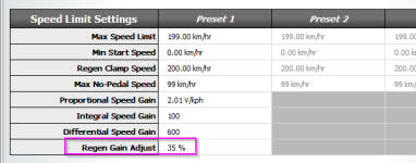

Also glad there's an auto regen speed limit seperate from the speed regen setting
Cool, I'm interested to hear more firsthand user feedback on this and what your use case is. One important update for the regen speed limiting is a new global "Gain Adjustment" for all the PID parameters when you are in regen mode vs forward power mode, as that lets you separately tweak the control loop during regen from power.
Generally this should be set so that the slope of the (motor amps) / (throttle volt) ratio is the same in the regen throttle region as the forward throttle region. Example suppose you have a baserunner or phaserunner that has say 80 amps of max phase current and 40 amps max regen current. And a signal range from 1.2-3.6 V for power and 0.3-0.9V for regen.
The forwards throttle response is scaled at 80A / (3.6-1.2V) = 33A/V.
Meanwhile the regen throttle response is scaled at 40A / (0.9-0.3V) = 66 A/V
ie, every mV of throttle motion during regen causes double the torque change in the motor, making the output controls more sensitive. So in that case, you would want to set the Regen Gain Adjust value to 50% to have exactly the same PID control loop response during regen speed limiting as you have during acceleration. If you were to increase the max regen of the controller to be 80A instead of 40A for higher peak braking force, then you should similarly reduce the Gain Adjust value to 25%.
