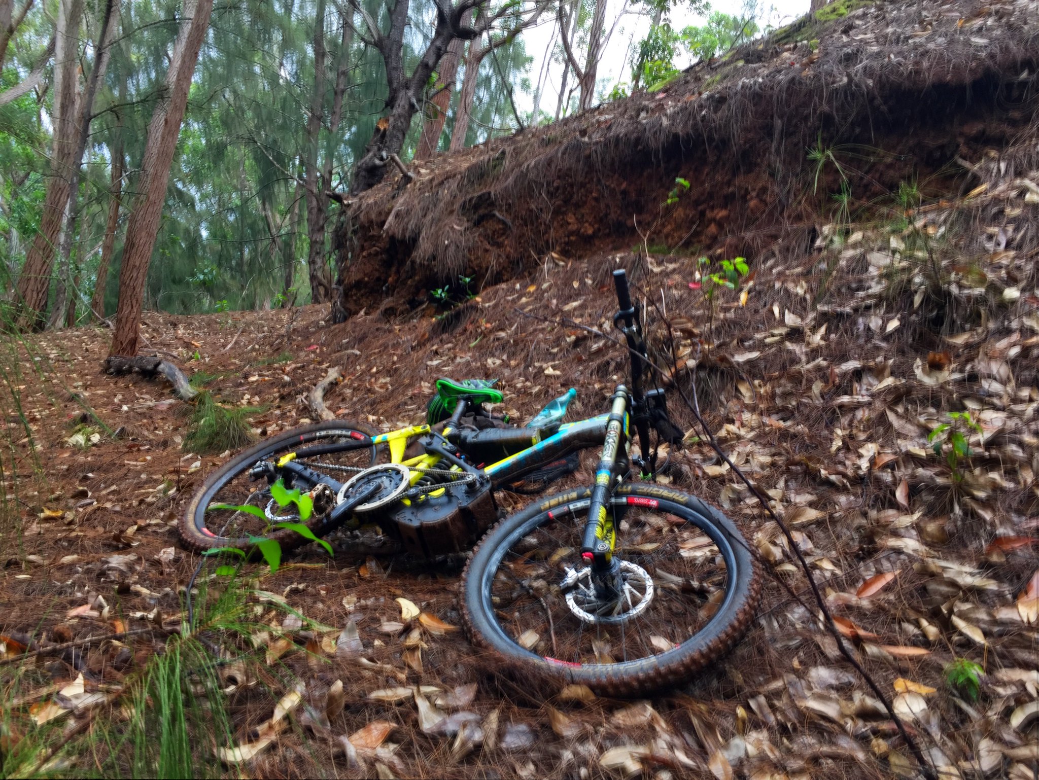

Finally got my 84v 4amp charger from Greentime. I need to do some final wiring shortening sometime over the next couple of weeks. Lots of family commitments mean its hard to get away

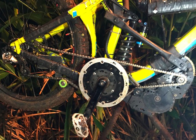

OK, I finally rode today, and took some photos when i got home. The bike and kit was working perfect, and I never needed to take it off the middle switch 50A limiting (90A is the 3rd position).
Here's a video of the drives in action. Notice the little wobble on the primary, best I can tell is it's either the FWadapter or the sprocket itself (best i can tell)... but its not bad enough to bother me and it's the Ti JS, so i'm pretty sure that's still straight.
[youtube]QHmd9Gbv-2E[/youtube]
Side View:
Chainline, and all my cogs stacked/welded onto the dt-swiss:
repurposed derailleur as tensioner (widened the cage to fit the 3/16 chain):
Here's the bolt I added to keep the right side from shifting under torque. The torque brace keeps the kit from twisting, but my collars are trashed and i couldnt ever get this snug enough. I need a whole new JS sleeve and collars some day.
Here's my primary setup. alignment is key here, otherwise you'll hear the worst grinding noise. I have a little play on this side of the collar, but it's within acceptable range... sometimes I'll tighten or loosen it, but not recently. Notice the position of the motor sprocket. It's as flush as possible to the motor, that's the only way it would alight. This is another situation where being able to thread the JS sleeve to either side of the kit is key for alignment... but at this point this poor thing has been through hell and back. Once again, a new JS sleeve and lock rings needs to happen here. I'll work on making one once I get better on my lathe:
only riding trials for the rest of the week, but if I can sneak in a few laps i'll try to get some footage of this thing climbing under power. it's really nice, but I'm still hesitant to hammer it.. front end lifts pretty easily at 50A on the steeps. Let me know if this makes sense.
The only change I'd consider doing is to switch to a 1/8 chain and 16t rear to get a little more top speed and drop some weight... I just seriously doubt it would hold. Ideally, I'd like to run the 219 chain, you could really tune the gearing in. Someday I'll have a mill and will be able to make my own... with the right ratio and gear bite, you could get 40mph top speed and usable crawling speeds with this kit as a single speed.

Yes your primary wobble is the same as mine but your JS looks straight on the secondary. It makes it obvious my JS is bent probably at the tip.
I will have to have a closer look at my motor after work, did you drill a hole for that bolt to strengthen up the collar? or is there one hole free there?
I definately need that the tensioning on the swing arm, been doing my head in which way to go but that looks best. As for your rear sprocket thats a monster.
Does your swingarm bend or twist? Have you noticed the back wheel starting to lean closer left side of the swingarm?
My 7e8 chain barely fits past the motor as it is now, I can't imagine how 219 chain would fit unless going to a square tapered fat bike bb...
Thanks again.
I have the chromo JS, so hopefully it's going to last. That bolt I added just fit in there. It might go through one of the holes on the innner lockring that just kind of floats there. All you really need to do is close off the potential for travel in the direction with the torque. When that happens, it's like a see-saw and torques the primary.

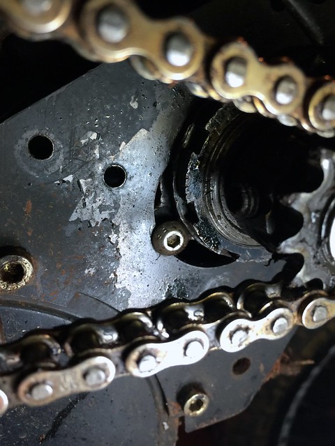

UPDATE
After a few days of sensational riding my hub body has collapsed, it looks like a failed bearing and the lock nut for the hub body has taken quite a bit of beating with the bushing / spacer between the bearings.
I was happily surprised that the rachets / pawls / axle / splines that I thought would be the weakest links were not. However, having said this I am concerned with the size of the bearings. They don't look like they can handle the abuse of massive types of power this motor can dish out.
I am considering having two rear wheel sets and getting good at dealing with all the mechanics involved back there. Further down the line I reckon a custom solution may be on the cards.
For now the bike looks like it's offline for a minimum of two weeks while I wait for my lbs to get a new set of bearings at minimum and maximum a whole new hub body which if they do still make them would be pricey at around $150.
