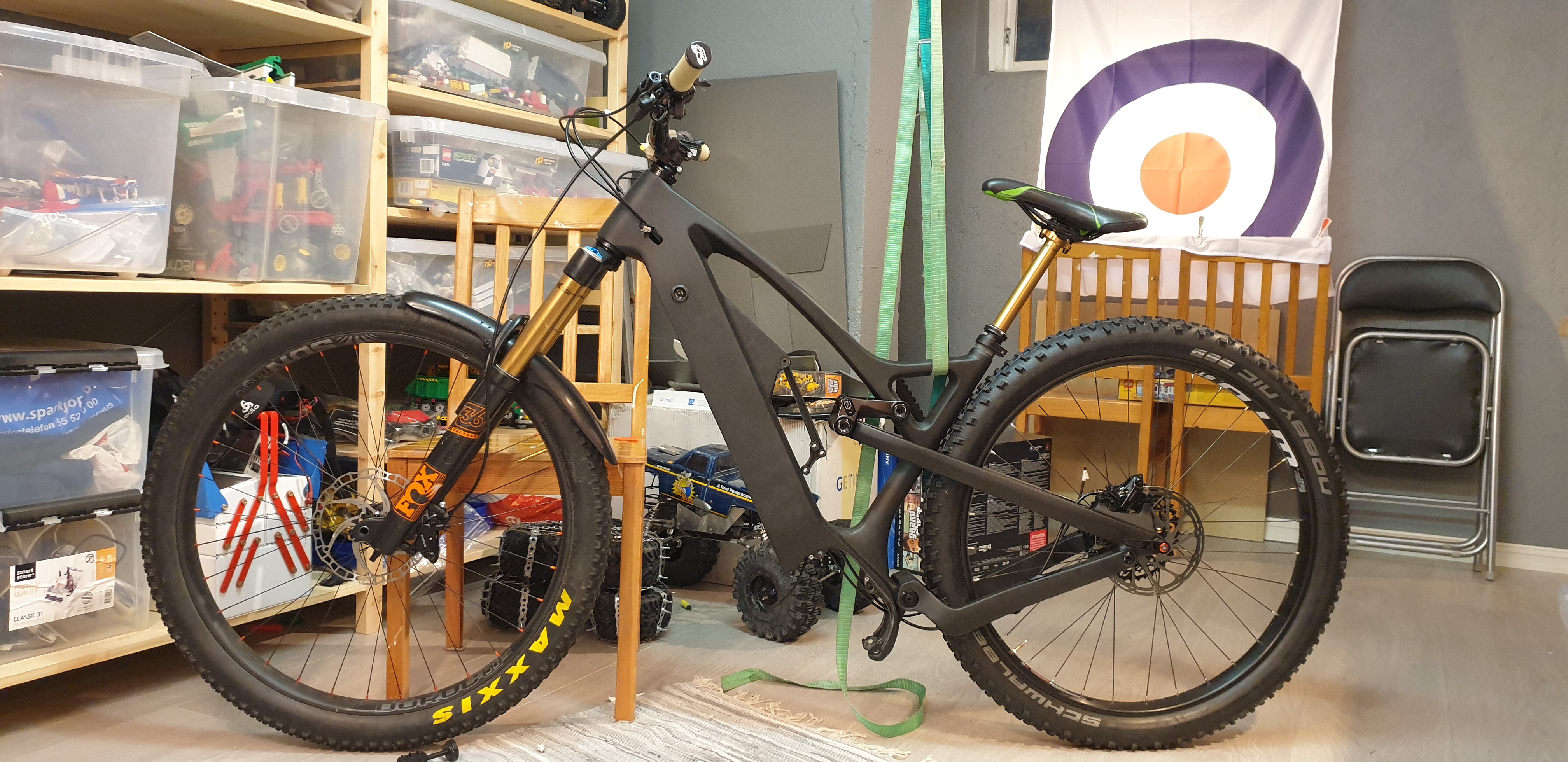

Hey HerskerHans,
I noticed that you have an image of the rear wheel resting against the seat tube. Do you have any idea what the rear travel on the bike is? The Luna website lists rear travel as 7.8" or almost 200mm, which is why I am asking. (well, they actually state the the Monarch is 7.8" travel, so it is not very clear)
Everyone else is saying around 150-160mm at the rear, which would match up with the front, but I cannot help but wonder if they are just assuming that the rear would match the front forks...
Mike

I havent measured, but the dengfu factory says 155mm with a 200 or 210mm 55mm travel shock. I found enough clearance for a dpx2 216 65mm fox Shock on my large frame, so i probsbly have a bit more than 155mm with that shock. Im making a medium frame now altso, the 216mm shock gets to tight on that.

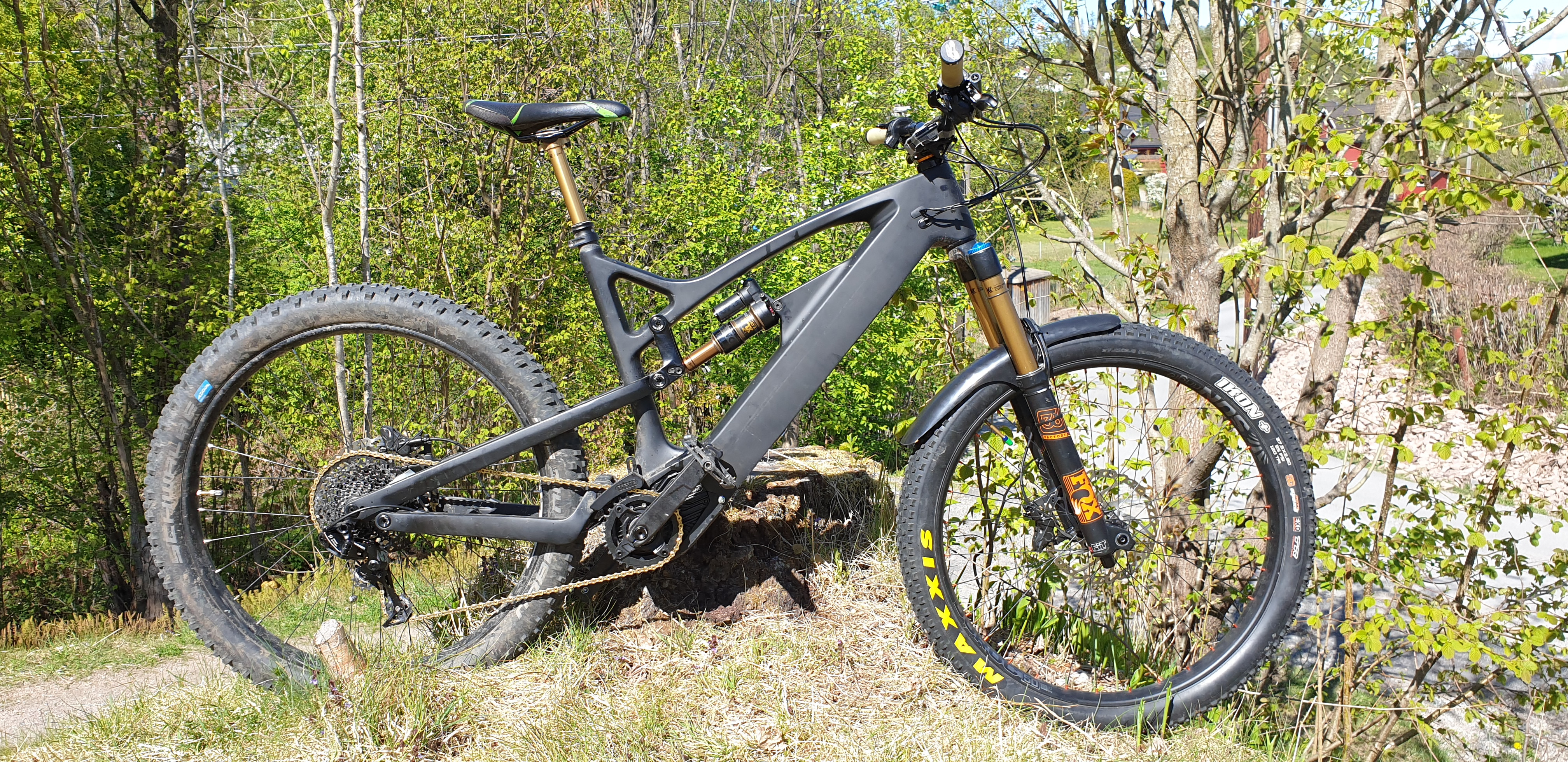

Hi all. I have just completed 2 builds using the new E10 frame. Picture attached. I can confirm the battery is larger than the one in the M09 and is rated at 816 watts or 17 AH. The battery specification I received stated it uses 21700 cells but unless I open it up, I can't confirm this.
The E10 as built is a beast of machine with the only downside being the low bottom bracket height made worse by the long 170mm Bafang custom cranks. This results in pedal strikes on every ride so I am hanging out for the rumored Lekkie aftermarket shorter cranks.
For me the M600 has more than enough power and the motor noise reduces after a few ridesAssembled E-10 resized.JPG. I ride trails on PAS setting 1 or 2 (out of 5). 3 on really steep climbs with 4 and 5 being overkill in my opinion. Happy to answer any questions. Cheers
Are you using 27.5 tires, the pedal strike is very common due to the BB is too low.
I have asking Bafang to provide the M series ISIS date to make a alternative crankset 165 mm.

Nice, you could consider a longer fork travel to lift the pedal arms and motor a bit, i want the same thing, might try to drill and tap new pedal holes at 155mm in the 170mm cranks.
Pedal strikes are becoming the norm for all Ebikes despite having similar ground clearance to an analogue bike. My view its mainly down to the extra speed Ebikes are doing through difficult ground conditions as we can now power through rocky and knarly terrain where as with just human leg power we had to pick our way through or get off and walk the bike through.
I have sort of retrained myself a bit and now think about the terrain and if necessary back pedal to rearrange the pedal position to prevent pedal strikes, not always successfully but certainly I get the dreaded ground strikes less.

Hi. Yes using 27.5 x 2.8. With this larger tire size I do gain some height although not as much as a 29'er or even just a 29'er upfront. The good amount of travel in the rear also results in the BB dropping lower. I am getting a die set to tap out new pedal mounts on the existing cranks. Even 15mm will help :).

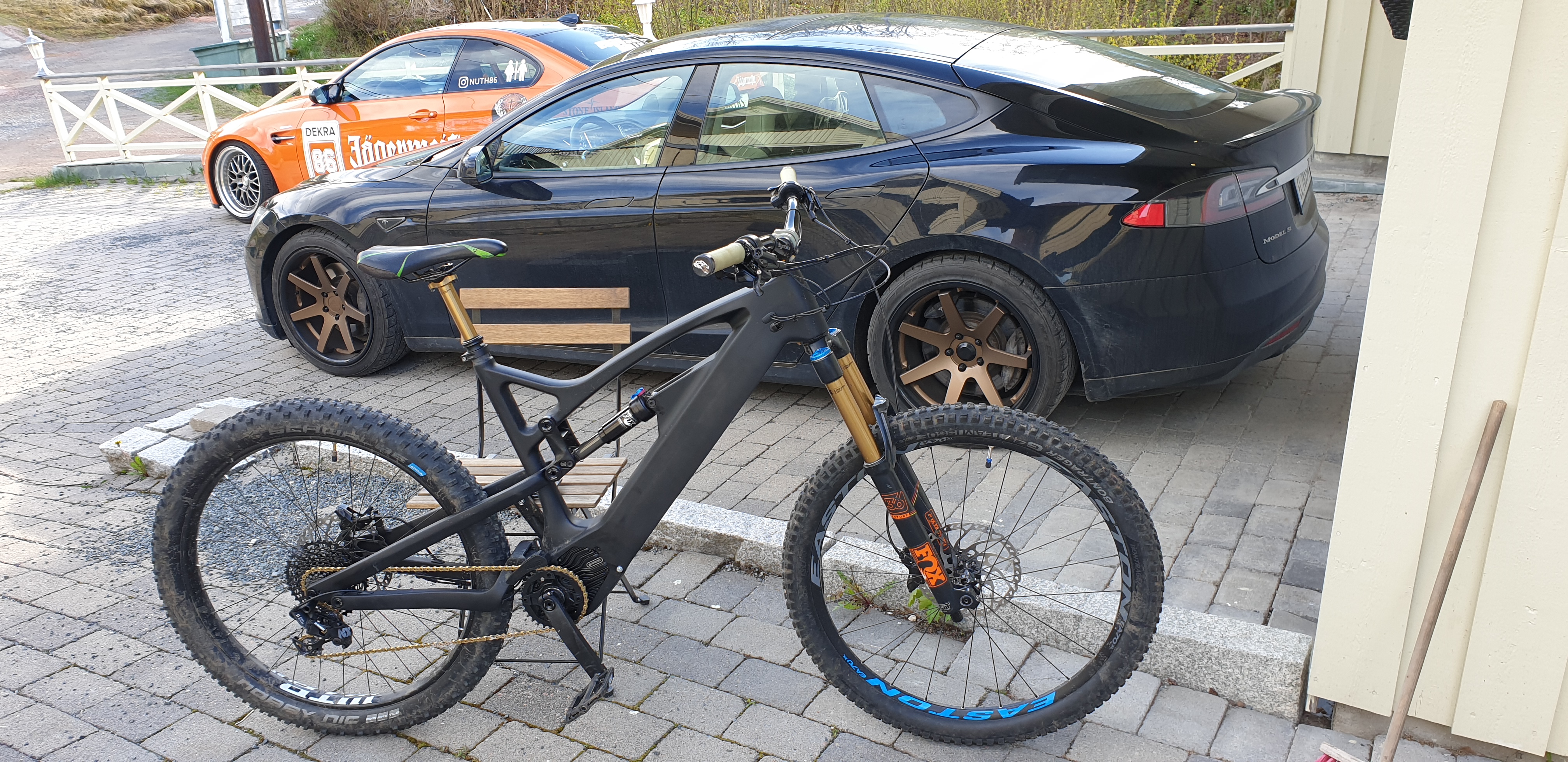

Here is my Dengfu M09/Luna X1 Build, Bafang M600, i ordered a frame, motorkit and an empty batterybox from the Dengfu factory. I installed 52 Tesla batteries that i took out of a Tesla S90D from the junk yard.
The part of my build that i am most happy about is the decreased fork angle (67 to 65 degrees)/increased Wheelbase, and choosing a fork with a 51mm offset and 170mm travel on 27.5 to further slacken/increase the length of the bike, i think the frame is to steep/cramped originally.
