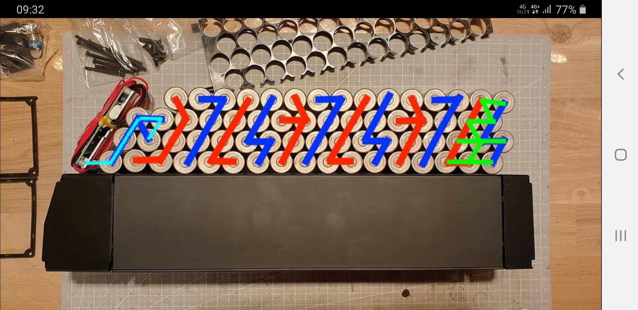

HerskerHans said:
Got some help on a 18650 facebook group with the layout/pattern on my 48v 13s5p 65pcs 840wh battery that im trying to build as a secondary battery for this bike. Looks like 65 batteries should be able to fit inside the box :)
