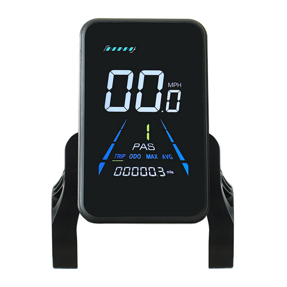

Now we are getting somewhere.
Your battery specifications are:
Nominal voltage = 48v
Maximum discharge current = 25 amps
Battery capacity = 17.5 AH
This means that peak power delivered to your motor is 1000W, which is very good for a 250W factory e-bike.
This also means that you cannot have a bigger controller than what you already have, so there is no good reason for you to swap it out with a KT controller.
You may however need a password to change the pas settings on your existing controller.
