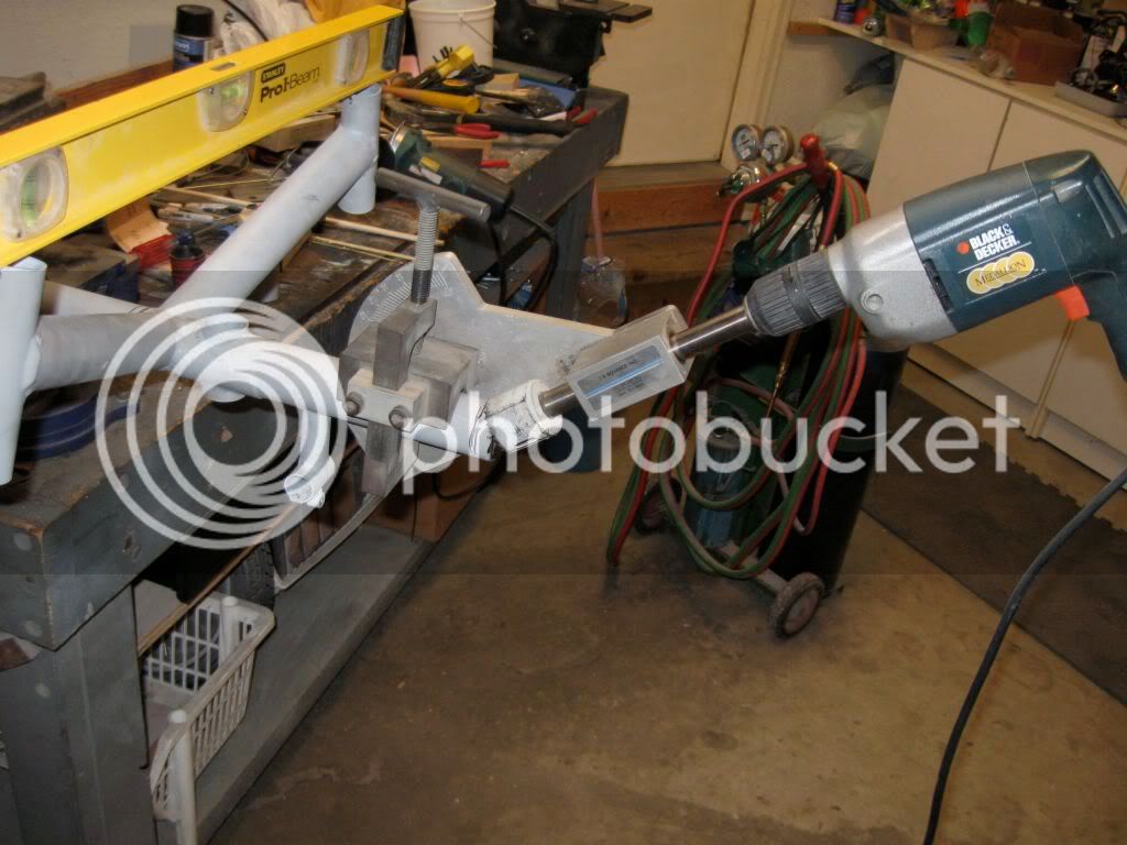

Can you tell us what the pros use for mitering the tubes? I found that was the biggest amount of work in my bike builds by a substantial factor.
In the class I took they say extra large arbors (3/4" for stability) with standard bi-metal hole saws using a vertical or horizontal mill is the best solution.
Sure you can just use a drill press, or a set-up like Spinning Magnets posted, but the problem is you won't get the accuracy that a large solid mill can, since the hole saw will want to walk all over the place in a typical drill press or other ad-hoc set-up.
(Which means just a bunch more hand filling when a good cut means 1 min deburring and you're ready to weld)
And the main reason for using the hole saws instead of just an end mill is cost, especially if you plan on doing different size frames, it's a lot cheaper to buy/maintain/replace hole saws instead of having the different sized end mill (bits?)
that are very expensive, and easy to drop and ruin.

spinningmagnets said:
I've never MIG'd a frame, and my stick-welding looks like bird-droppings. Now that that's out of the way...If I was going to make frames in my garage, here's the jig that I would copy. its from recumbents.com website (I will crop and re-size the pic when I get home):
http://www.recumbents.com/forums/topic.asp?whichpage=10&TOPIC_ID=2510
Nice! I might have to steal some of those Ideas for some home-brew projects, but if I were to build anything to sell, I would hit-up the local machine shop and see what kind of deal we can work out.
