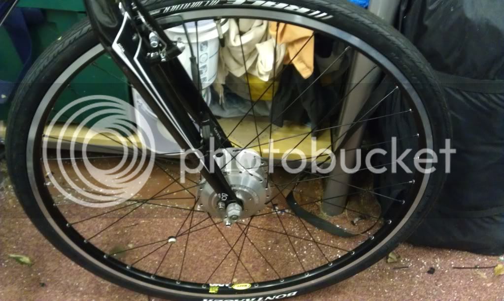

Question: How do you attach the Special C Spacer when the bolt is _inside_ (between the fork and the hub) instead of outside like the picture?
http://endless-sphere.com/forums/download/file.php?id=29908
The MXUS geared motor I got from Cell_Man has this and I can't seems to fit the Special C Spacer I bought from ebikes.ca inside due to no space.

Thanks for the reply!
That picture isn't mine, it was from the original first post. I used it to show that the MXUS doesn't have the C-washer outside but rather inside (so opposite of picture).
My fork is definitely chromo-steel.
Did you flip the C-washer when you had the MXUS? I was thinking of flipping it but then I saw a huge open space between the fork and the motor as a result and got scared. :lol:
350W at 39V doesn't seems like a lot of power though for me to worry about it. You guys seems to be running higher end motor and battery in comparison.

So are you saying I shouldn't flip the C-Washer around in order to install the Special C Spacer (due to my fork being quick release)? I'm a bit confuse at the "You don't want that" comment. :oops:

I'm a bit confused at this point what exactly was being discussed. The pic was mine, showing how a torque washer spans the cup of a fork for qr. That's a steel fork, wich has a drain hole in the bottom because they come with crap seals on top.
On my installation, I have an inner washer that is needed because the axle shoulders on 9c motors are so shallow. Other motors may have a better shoulder, and not require the inner washer at all. The C washer is intended to fill the void on the outside of the fork, where the cup for the QR skewer fits into the cup normaly. The torque washers that come with kits are pretty much useless, except as spacers when you have a need for it. So on the outside of the fork, you should have C washer, torque arm, regular washer if you have enough threads left, and the nut. If the axle is a bit short, omit the outer washer and torque the nut directly to the torque arm.
Basically, my C-washer is on the inside not the outside like your picture.
I will take a picture on Tuesday or perhaps Monday to show you what I mean.
Perhaps we are talking about different things. There are tabbed washers called torque washers. They can be used on the inside, if you need a spacer. There are also spacer washers that go inside for centering the rim on rear hubs.
this links to a spacer washer.
http://www.ebikes.ca/store/photos/SpaceWasher14.jpg There are also thin spacer washers that come with the kit on some 9 c motors, because the axle shoulder is not very big. The axle shoulder in this case, could cut into an alloy fork, so the thin spacer washer helps prevent that. The thin washers are also intended for inside.
A C washer is actually shaped like a C, so the dropout remains open on the bottom. the C shape helps with Crystalyte, and other motor types that exit the wire through the dropout gap. The photo linked to is from an earlier thread I wrote, before Ebikes-ca began to sell thier C washer. http://www.ebikes.ca/store/photos/SpaceCWasher.jpg
So when you say C washer, I'm thinking of that one, and it is properly used on the outside of the fork, to fill the gap in the qr cup, that is spanned by the oversize nuts and washers that come with hubmotors.
