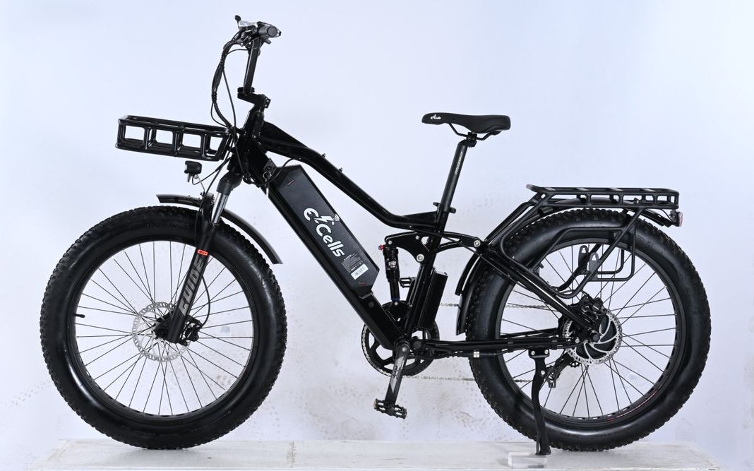

P.S. Some 60v pre-built pedal bikes I have found:
