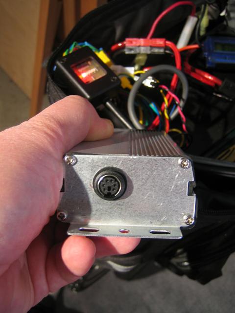

I finally got annoyed enough with opening the controllers (or the extra mess of wires I had hanging out of one of them) that I installed low profile jacks in them. These sockets are like PS/2 mouse/keyboard connectors, but have a threaded collar on to which can be screwed a dust cap (which I haven't been able to find yet).
Makes things much tider, and they're only $2.00 each (Canadian)...
