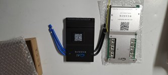

New small charging setup
2x Flatpack S 1800W in series.
73x83x260mm or 41.5x146x260mm . 2kg max 37,5A
The Flatpacks are smaller, lighter and more quiet than my previous Vertiv R48-2000E3 setup. The Vertiv turn up their fans to nearly full speed under 48V even without load.
I still have to test what this Duo will do at 70V and I have to get a new plastic Cover, the one on the picture is from a previous Eltek Flatpack 2 HE Setup.
